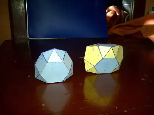

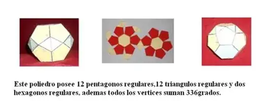

A friend of mine, Jose Joel Leonardo, is claiming to have discover a new "regular" polyhedron, or, at least, a new type of regular polyhedron. Can anyone tell whether he is right or not? Below there is a image with a model from which you would be able to construct the polyhedron. Thanks in advance.

2Does that really fit together? – Mariano Suárez-Álvarez Apr 29 '17 at 17:45
@Mariano, that I wonder too? – Emmanuel José García Apr 29 '17 at 17:47
He constructed this https://www.facebook.com/photo.php?fbid=223729291084338&set=pb.100003418053195.-2207520000.1493488269.&type=3&theater – Emmanuel José García Apr 29 '17 at 17:52
1Paper is flexible, and allows for lots and lots of wiggle... Really fitting together is not something that you can prove by making a paper model. – Mariano Suárez-Álvarez Apr 29 '17 at 19:48
I agree with you, Mariano! So, can anyone prove or disprove that really fit together? – Emmanuel José García Apr 29 '17 at 19:50

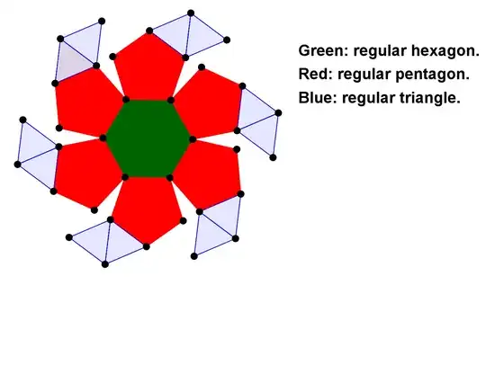

@MarianoSuárez-Álvarez it does not fit. Half the third edge of the isosceles triangle used is not equal to $\frac{1}{2},$ rather $\sqrt \phi - \sqrt {\phi - 1} \approx 0.4858$ – Will Jagy Apr 29 '17 at 21:43
such a difference is quite sensible that assembling the figure by a CAD program should be noticeable (better than paper). But unfortunately I am not expert with CAD, is anybody here ? – G Cab Apr 29 '17 at 22:02

No, they are not all regular polygons.
The pictured solid works with isosceles triangles that are almost equilateral but not perfect. I found this critical fact,
Dihedral angles between tetrahedron faces from triangles' angles at the tip
This says that when a regular hexagon and two regular pentagons meet at a vertex, the dihedral angle between the hexagon and a pentagon has
$$ \cos \theta = \frac{(1 - \sqrt 5) \sqrt 3}{\sqrt{10 + 2 \sqrt 5}}, $$ $$ \sin \theta = 2 \sqrt{\frac{\sqrt 5 - 1}{5 + \sqrt 5}} $$
It follows that the first vertex of a pentagon is this distance above the plane of the hexagon, $$ \sqrt{\frac{\sqrt 5 - 1}{2}}, $$ while the highest point of the pentagon is $$ \sqrt{\frac{\sqrt 5 + 1}{2}} $$ over the hexagon plane. The height difference, which would be exactly one half for an equilateral triangle, is actually $$ \sqrt{\frac{\sqrt 5 + 1}{2}} - \sqrt{\frac{\sqrt 5 - 1}{2}} = \sqrt \phi - \sqrt {\phi - 1} \approx 0.485868 $$
- 139,541
We can prove the height difference is less than one-half without the numerical calculation. Note that $\sqrt\phi+\sqrt{\phi-1}$ and $\sqrt\phi-\sqrt{\phi-1}$ are reciprocals summing to $2\sqrt\phi$. This sum is greater than $5/2$ because $(5/4)^2[(5/4)^2-1]=225/256<1$, so the smaller term $\sqrt\phi-\sqrt{\phi-1}$ must be less than $1/2$. – Oscar Lanzi May 07 '21 at 09:51
As the other answers said, this is not a regular polyhedron. I suspect you referred to the fact that all the faces are regular polygons. Such a polyhedron would be called a Johnson solid: https://en.m.wikipedia.org/wiki/Johnson_solid
They are completely enumerated and at first glance I couldn't see your friend's among them.
Edit: As confirmed by Will Jagy's answer - the triangles are not equilateral, so this is not a Johnson solid
