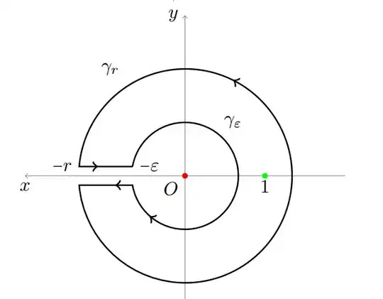

Consider the function
$$f(z) = \frac{(z-1)^2}{(1-(z+\log z))(1-(z-\log(z))}$$
Integrated around a key-hole contour around the principle branch of the logarithm
$$\log(z) = \log|z|+i\mathrm{Arg}(z)$$
Hence the contour
By taking the limits the smaller circle and the bigger one go to zero hence
$$\int_{-\infty}^{0}\frac{(x-1)^2}{(1-(x+\log|x|+i\pi ))(1-(x-\log|x|-i\pi)}dx+\int_{0}^{-\infty}\frac{(x-1)^2}{(1-(x+\log|x|-i\pi ))(1-(x-\log|x|+i\pi)}dx = 2\pi i\mathrm{Res}(f,1)$$
Convert to the positive limit
$$\int_{0}^{\infty}\frac{(x+1)^2}{(1+x-\log x-i\pi )(1+x+\log x+i\pi)}-\frac{(x+1)^2}{(1+x-\log x+i\pi )(1+x+\log x-i\pi)}dx = 2\pi i\mathrm{Res}(f,1)$$
This magically reduces to our integral
$$\int_{0}^{+\infty}{4\pi \,i \log(x) \over \pi^2+(x-\log(x)+1)^2}\cdot{(x+1)^2\over \pi^2+(x+\log(x)+1)^2}\cdot \mathrm dx = 2\pi i\mathrm{Res}(f,1)$$
Note that
$$\mathrm{Res}(f,1) = \lim_{z \to 1}\frac{(z-1)^3}{(1-(z+\log z))(1-(z-\log(z))} = 1$$
Hence we finally get our result
$$\int_{0}^{+\infty}{\log(x) \over \pi^2+(x-\log(x)+1)^2}\cdot{(x+1)^2\over \pi^2+(x+\log(x)+1)^2}\cdot \mathrm dx = \frac{1}{2}$$
