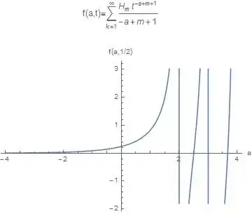

The graph shows $f(a,t=1/2)$ as a function of $a$

I have checked the validity of both $f(a,t)$ and $f_{1}(a,t)$ by plotting them together with a partial sum of $S_a(t)$ as a function of $a$ for $t=1/2$. All three curves agree reasonably.
Unfortunately, my attempts to perform an independent validity check by comparing power series in $t$ failed. This might be due to difficulties in Mathematica and needs further study.
