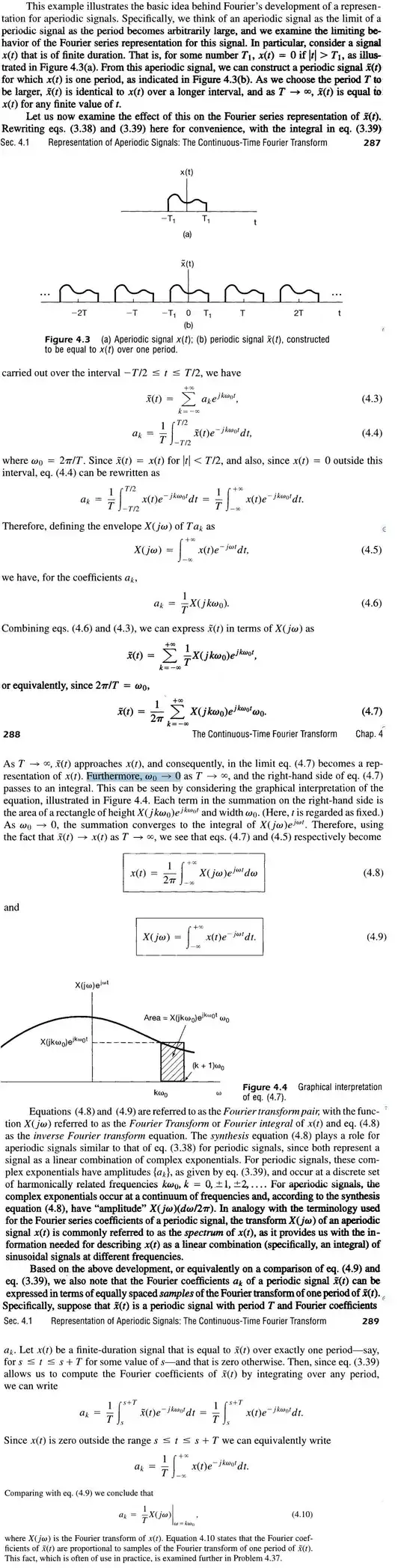

I think one of the best intuitive explanation of the relation between Fourier series and Fourier transform was given in [Alan V. Oppenheim, Alan S. Willsky, Hamid Nawab. "Signals and Systems", 2ne edition, Section 4.1.1, pages 286-289]
