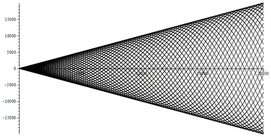

The answer to the first question will depend on the details of rational approximations of $\pi$, perhaps more than is actually known. A plot of $n \sin(n)$ shows some interesting apparent structure, probably due to some very good rational approximations.
