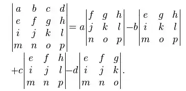

Some suggests a Row Reduction to create zeros in rows or columns, then use expansion by minors along that row/column. But I find this method easier to understand.
I hope it helps! :)

Thanks for your job! But I'm trying to reach a general version by starting in this point.. If the size is bigger and bigger, unfortunately yours will fall down :( – Yalçın Cenik Mar 29 '17 at 11:34
Sorry, but "Laplace expansion" of determinants has rarely a practical interest : the generated computations are huge ... – Jean Marie Mar 29 '17 at 13:31
