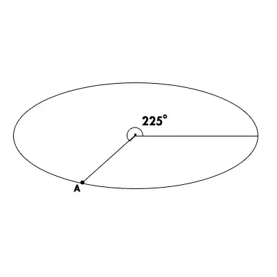

I need to find a point (A on this diagram) given the center point of the ellipse as well as an angle. I've been melting my brain all day (as well as searching through questions here) testing out different equations. What's the best way to do this?
I intend to grab point A at $225^o$ as well as another point at approximately $250^o$ using the same math. These need to be fetched regardless of elliptic width and height.

If the ellipse is centered at the origin, the equation of the ellipse is $\frac{x^2}{a^2}+\frac{y^2}{b^2}=1$. The equation of the line is $y=x\tan \theta $ So you have $\frac{x^2}{a^2}+\frac{(x\tan \theta )^2}{b^2}=1$ or $x=\pm \frac{ab}{\sqrt{b^2+a^2(\tan \theta)^2}}$ where the sign is + if $ -\pi/2 \lt \theta \lt \pi/2$

  • Well, this is embarrassing. The code I was working with already fetches the exact same value this does. I was sure my math was wrong. It looks like I'll have to figure out how to handle this data in Flash given its wonky co-ordinate system. Regardless, thanks for the quick answer. – null Feb 14 '11 at 23:53
    Similarly for y: $y=\pm \frac{ab}{\sqrt{a^2+\frac{b^2}{(\tan \theta)^2}}}$ – Charles L. Jul 25 '14 at 00:25
  • @CharlesL. : why would you get y like that instead of simply $y=\sqrt{ 1-(x/a)^2 } * b$ if you have x already? – B M Oct 16 '15 at 14:17
  • BM Does not work for all angle. @CharlesL. But the sign condition is different, isn't it? – ZoolWay Oct 28 '16 at 18:53
  • Ross' + Charles' formulas for x and y respectively are the correct ones, the other ones in this thread didn't work for me (though maybe I was doing smth wrong, dunno). – Alex the Ukrainian Dec 09 '23 at 11:10

You can also use parametric equations:
$$x=a\cos(\theta)$$ $$y=b\sin(\theta)$$
Where $a$ is the radius on the horizontal axis, and $b$ is the radius on the vertical axis.
    In this parametrization, $\theta$ is not the angle of the post, for example for $\theta=225$ of the diagram the corresponding point on the ellipse is not given by your formulas. – coffeemath May 19 '13 at 17:28
  • @coffeemath Why wouldn't $x = a\cos(225°)$ and $y=b\sin(225°)$ work? – rurouniwallace May 19 '13 at 17:33
    @Zettasurro -- those equations will give you a point on the ellipse. But the polar angle of this point will not be 225 degrees. – bubba May 19 '13 at 23:28
  • @Zettasurro The angle from the point you mention in your comment would have tangent equal to $(b/a)\tan(225)$, and so would not be 225 degrees unless $a=b$ (the ellipse is a circle). – coffeemath May 20 '13 at 01:05
  • @coffeemath Why is that a problem? Since it's not a circle, doesn't it make sense for the slope of the tangent not to equal $\tan(225)$? – rurouniwallace May 20 '13 at 01:11
    Look again at the problem posted. The angle 225 marked in the diagram is the angle centered at the ellipse center (midpoin of foci) with initial side the positive $x$ axis and terminal side as marked, and is to be 225 degrees. In general if $(x,y)$ is on the terminal side of such an angle, one has $\tan \theta=y/x$. But with your point $(x,y)=(a \cos 225, b \sin 225)$ you get $y/x=(b/a)\tan 225$ which is not $\tan 225$ unles $a=b.$ – coffeemath May 20 '13 at 12:47

    @fguillen I’m guessing you did not actually need the exact angle you specified. This gives a symmetrical mapping onto the ellipse so it looks a lot like it is working. So how do we check the angle? The point (cos(θ), sin(θ)) gives the angle we want, as does any point which scales them equivalently. That’s how you know you’re on the line for θ. One of those points gives the intersection we want. But this approach scales them differently, so how can it be on the same line? As you go around this way you’ll find some areas are more compressed or stretched than others. – Mark E. Jun 29 '23 at 05:04

If the ellipse is centered at $(0,0)$, $2a$ wide in the $x$-direction, $2b$ tall in the $y$-direction, and the angle you want is $\theta$ from the positive $x$-axis, the coordinates of the point of intersection are $$\left(\frac{a b}{\sqrt{b^2+a^2\tan^2(\theta)}},\frac{a b \tan(\theta)}{\sqrt{b^2 + a^2\tan^2(\theta)}}\right) \text{ if }0\le\theta< 90°\text{ or }270°<\theta\le360°$$ or $$\left(-\frac{a b}{\sqrt{b^2+a^2\tan^2(\theta)}},-\frac{a b \tan(\theta)}{\sqrt{b^2 + a^2\tan^2(\theta)}}\right) \text{ if }90°<\theta< 270°.$$

  • Doesn't $\tan$ become negative for $\theta \gt 90^{\circ}$ so the signs are flipped over $90^{\circ}$ to $270^{\circ}$ – Ross Millikan Feb 14 '11 at 23:36
  • @Ross: I think I've got the signs and ranges right now (perhaps you were looking at my initial post with incorrect ranges). For example, between 90° and 180°, using the second formula and tangent is negative, the $x$-coordinate is negative and the $y$ coordinate is positive (opposite of the negative tangent), which is correct for angles between 90° and 180°. – Isaac Feb 14 '11 at 23:43
  • Looks good to me – Ross Millikan Feb 15 '11 at 01:20
  • I think there's a small error here still. Where it says "90° < θ < 270°" it should be "90° < θ <= 270°". – Tony Feb 09 '18 at 22:27
    @Tony I think 90° and 270° are excluded because $\tan\theta$ would be undefined. – Isaac Feb 10 '18 at 19:37

I think there might be an alternative that doesn't need to define a piecewise function and we don't have problems in handling some angles:
$x(\theta) = r(\theta)cos(\theta)$
$y(\theta) =r(\theta)sin(\theta)$
where $r(\theta)$ is the radius of the ellipse given $\theta$ and is given by $r(\theta)=\frac{ab}{\sqrt{a^2sin^2(\theta)+b^2cos^2(\theta)}}$, see here.
N.B.: This works as well for an ellipse tilded by an angle of $\phi$ and the parametrisation is
$\begin{bmatrix}x(\theta)\\y(\theta)\end{bmatrix} = \begin{bmatrix}cos(\phi)&-sin(\phi)\\sin(\phi)&cos(\phi)\end{bmatrix}\begin{bmatrix}r(\theta-\phi)cos(\theta-\phi)\\r(\theta-\phi)sin(\theta-\phi)\end{bmatrix}$
roi_saumon
  • 4,196
The equation of an ellipse in its origin centered form is:
$(\frac{cos \theta} {a})^2 + (\frac{sin \theta} {b})^2=(\frac{1}{ r})^2 $.
Hope you take it from there.
