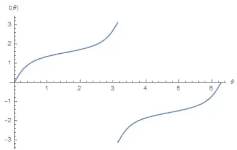

{a, b} = {6, 2};
x[θ_] := a b Cos[θ] / Sqrt[(a Sin[θ])^2 + (b Cos[θ])^2]
y[θ_] := a b Sin[θ] / Sqrt[(a Sin[θ])^2 + (b Cos[θ])^2]
Plot[ArcTan[x[θ] / a, y[θ] / b], {θ, 0, 2π}, AxesLabel -> {"θ", "t(θ)"}]
