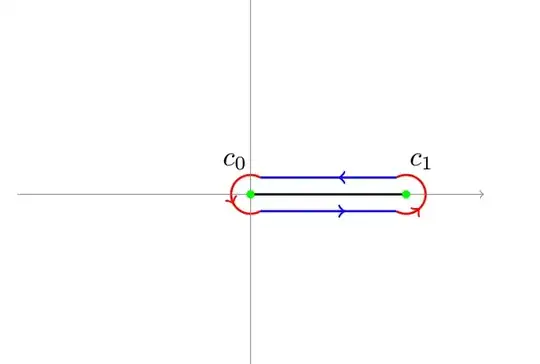

Prove that
$$\int^{1}_{0} \sqrt{x}\sqrt{1-x}\,dx = \frac{\pi}{8}$$
$$\textit{proof}$$
Consider the function
$$f(z) = \sqrt{z-z^2} = e^{\frac{1}{2}\log(z-z^2)}$$
Consider the branch cut on the x-axis $$x(1-x)\geq 0\,\, \implies \, 0\leq x \leq 1 $$
Consider $ w= z-z^2 $ then
$$\log(w) = \log|w|+i\theta,\,\, \theta\in[0,2\pi)$$
Consider the contour
enter image description here Consider the integral
$$\int_{c_0}f(z)\,dz+\int_{c_1}f(z)\,dz+\int^{1-\epsilon}_{\epsilon} e^{\frac{1}{2}\log|x-x^2|}\,dx-\int^{1-\epsilon}_{\epsilon} e^{\frac{1}{2}\log|x-x^2| +\pi i}\,dx = 2\pi i \mathrm{Res}(f,\infty)$$
Consider the Laurent expansion of
$$\sqrt{z-z^2} =i \sqrt{z^2} \sqrt{1-\frac{1}{z}}= iz\sum_{k=0}^\infty{\frac{1}{2} \choose k} \left(-\frac{1}{z} \right)^k$$
Hence we deuce that
$$ \mathrm{Res}(f,\infty) = -\frac{i}{8}$$
That implies
$$\int_{c_0}f(z)\,dz+\int_{c_1}f(z)\,dz+2\int^{1-\epsilon}_{\epsilon} \sqrt{x}\sqrt{1-x}\,dx = \frac{\pi}{4}$$
Considering integrals the contours around $c_0$ and $c_1$ go to zero . Finally we get
Question
I have my concerns about the expansion at infinity
First I am assuming that $\sqrt{z^2} = z$ which seems to be wrong on the chosen branch cut. Also it is wrong to assume that $\sqrt{zw} = \sqrt{z}\sqrt{w}$.

There is a conceptual error in the OP.
Note that if $w=z(1-z)$, then the condition $\arg(w)\in[0,2\pi)$ restricts the domain of the complex $z$ plane to a half space.
To see this, we write $z=|z|e^{i\arg(z)}$ and $1-z=|1-z|e^{i\arg(1-z)}$ so that $w=|z||1-z|e^{i\left(\arg(z)+\arg(1-z)\right)}$.
Inasmuch as $\arg(z)+\arg(1-z)$ spans a range of $4\pi$ in the complex $z$-plane, then $\arg(w)$ does likewise.
To address the concerns in the OP in detail, we begin with a short primer.
PRIMER:
The complex logarithm $\log(z)$ is defined for $z\ne 0$ as
$$\log(z)=\log(|z|)+i\arg(z) \tag 1$$
It is easy to show that the complex logarithm satisfies
$$\log(z_1z_2)=\log(z_1)+\log(z_2) \tag 2$$
which means that any value of $\log(z_1z_2)$ can be expressed as the sum of some value of $\log(z_1)$ and some value of $\log(z_2)$.
To see that $(2)$ is true, we simply note that $\log(|z_1||z_2|)=\log(|z_1|)+\log(z_2)$ and $\arg(z_1z_2)=\arg(z_1)+\arg(z_2)$.
NOTE: The relationship in $(2)$ is not generally satisfied when the logarithm is restricted on, say, the principal branch for which $\arg(z)=\text{Arg}(z)$, where $-\pi<\text{Arg}\le \pi$.
Using $(2)$, we can write for $z\ne0$, $z\ne 1$
$$\begin{align} f(z)&=\sqrt{z(1-z)}\\\\ &=e^{\frac12 \log(z(1-z))}\\\\ &=e^{\frac12 \left(\log(z)+\log(1-z)\right)}\\\\ &=e^{\frac12\log(z)}e^{\frac12\log(1-z)}\\\\ &=\sqrt{z}\sqrt{1-z} \end{align}$$
SELECTING A BRANCH OF $\displaystyle \sqrt{z(1-z)}$
To obtain a specific branch of $\sqrt{z(1-z)}$, we can use a branch of $\sqrt{z}$ and another branch of $\sqrt{1-z}$.
If we select the branches for $\sqrt{z}$ and $\sqrt{1-z}$ to be such that $-\pi<\arg(z)\le \pi$ and $0<\arg(1-z)\le 2\pi$, then the branch of $\sqrt{z(1-z)}$ is such that
$$\sqrt{z(1-z)}=\sqrt{|z||1-z|}e^{i\frac12 (\arg(z)+\arg(1-z))}$$
with $-\pi<\arg(z)+\arg(1-z)\le 3\pi$.
With this choice, it is straightforward to show that $\sqrt{z(1-z)}$ is analytic on $\mathbb{C}\setminus [0,1]$.
EVALUATING THE INTEGRAL
Then, we can write
$$\begin{align} \oint_C \sqrt{z(1-z)}\,dz&=\int_0^1 \sqrt{x(1-x)}e^{i(0+2\pi)/2}\,dx+\int_1^0\sqrt{x(1-x)}e^{i(0+0)}\,dx\\\\ &=-2\int_0^1 \sqrt{x(1-x)}\,dx \tag 3 \end{align}$$
NOTE: We bypassed consideration of the contributions to the integral from the circular deformations around the branch points since their contributions vansish in the limit as the radii go to zero.
Using Cauchy's Integral Theorem, the value of the integral $\oint_C \sqrt{z(1-z)}\,dz$ is unaltered by deforming $C$ into a circular contour, centered at the origin, of radius, $R>1$. Hence, exploiting the analyticity of $\sqrt{z(1-z)}$ for $R>1$, we have
$$\begin{align} \oint_C \sqrt{z(1-z)}\,dz&=\oint_{R>1}\sqrt{z(1-z)}\,dz\\\\ &=\int_{-\pi}^{\pi}\sqrt{Re^{i\phi}(1-Re^{i\phi})}\,iRe^{i\phi}\,d\phi\\\\ &=-\int_{-\pi}^{\pi} \left(iRe^{i\phi}\right)^2 \left(1-\frac{1}{Re^{i\phi}}\right)^{1/2}\,d\phi\\\\ &=-\int_{-\pi}^{\pi} \left(iRe^{i\phi}\right)^2 \left(1-\frac{1/2}{Re^{i\phi}}-\frac{1/8}{(Re^{i\phi})^2}-\frac{1/16}{(Re^{i\phi})^3}+O\left(\frac1{(Re^{i\phi})^4}\right)\right)\,d\phi\\\\ &\to -\frac{\pi}{4}\,\,\text{as}\,\,R\to \infty \tag 4 \end{align}$$
Finally, putting together $(3)$ and $(4)$ yields
$$\int_0^1 \sqrt{x(1-x)}\,dx=\frac{\pi}{8}$$
as expected.
NOTE: The expansion leading to $(4)$ is correct given the chosen branches of $\sqrt{z}$ and $\sqrt{1-z}$. Then,
$$\begin{align} \sqrt{z(1-z)}&=\sqrt{-z^2\left(1-\frac1z\right)}\\\\ &=e^{\frac12\log(-z^2)+\frac12\log\left(1-\frac1z\right)}\\\\ &=iz \sqrt{1-\frac1z} \end{align}$$
where we used $\log(-1)=i\pi$ and $\log(z^2)=2\log(z)$. Then, upon expanding $\sqrt{1-\frac1z}$ in its Laurent series in the annulus $1<z<\infty$, and setting $z=Re^{i\phi}$, we obtain the expansion used to arrive at $(4)$.

  • Hey Mark, I appreciate the effort. I still have some confusion you are saying that I have restricted the value of the argument but I know that any complex number argument should be restricted to a period of length $2\pi$ in order to make it single-valued. – Zaid Alyafeai Feb 14 '17 at 19:02
  • Zaid, I understand. In this case, we are mapping the $z$-plane to the $w$ plane. And we can see that $w$ gets covered twice. This is no different from the mapping of $w=z^2$ for which the upper half $z$-plane maps into the entire $w$ plane and the lower half $z$-plane does likewise. We really need $\sqrt{z(1-z)}$ to be single valued by selecting a branch- and it is single valued given the chosen branches for $\sqrt{z}$ and $\sqrt{1-z}$. Its argument is on the interval $(-\pi/2,3\pi/2]$. – Mark Viola Feb 14 '17 at 19:21
