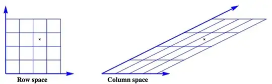

The figure shows an example where
\mathbf{A} =
\left[
\begin{array}{cc}
1 & 2 \\
0 & 1 \\
\end{array}
\right]
The row space is envisioned as a regular grid. The action of $\mathbf{A}$ on this grid produces the image of the column space.

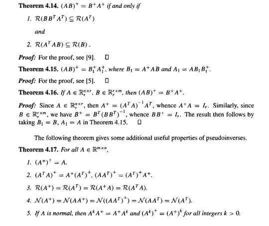

A succinct and illuminating discussion is given by Laub in Matrix Analysis for Scientists and Engineers
Excerpt:
[11]:
