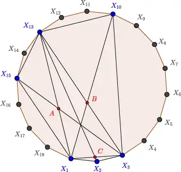

Let $A,B,C$ be the intersection point of $X_{13}X_1$ with $X_{15}X_3$, $X_{13}X_3$ with $X_{10}X_1$, $X_{13}X_2$ with $X_1X_3$ respectively.
Then, we get $$\begin{align}\frac{AX_1}{X_{13}A}\cdot\frac{CX_3}{X_1C}\cdot\frac{BX_{13}}{X_3B}&=\frac{X_1X_3\sin 40^\circ}{X_{13}X_3\sin 20^\circ}\cdot\frac{X_3X_{13}\sin 10^\circ}{X_1X_{13}\sin 10^\circ}\cdot\frac{X_1X_{13}\sin 30^\circ}{X_1X_3\sin 70^\circ}\\\\&=\frac{\sin 40^\circ\sin 30^\circ}{\sin 20^\circ\sin 70^\circ}\\\\&=\frac{\frac 12\sin 40^\circ}{\sin 20^\circ\sin 70^\circ}\\\\&=\frac{\sin 20^\circ\cos 20^\circ}{\sin 20^\circ \sin 70^\circ}\\\\&=1\end{align}$$ The claim follows from Ceva's theorem.

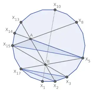

Let $X_2X_{13}$, $X_5X_{14}$, $X_8X_{15}$ meet at $A$ (by symmetry about $X_5X_{14}$). Then $\triangle X_2X_3X_{17}$ and $\triangle AX_{15}X_5$ have parallel corresponding sides, so they are homothetic about some point $B$, which lies on $X_2X_{13}$, $X_3X_{15}$, and also $X_1X_{10}$ (by symmetry about $X_1X_{10}$).
diagram
That's how they can be concurrent. I'm currently working on a proof :)
