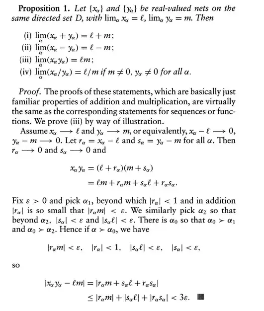

I find this practice irksome for several reasons: it makes it tough on the reader; it may indicate a lack of understanding by the writer; and it contributes to a perception of mathematics as being abstruse and rife with legerdemain.
The practice seems to arise once formal proof writing rears its head, although less so in, say, an early course on Euclidean geometry. One of the first places I notice it is when $\varepsilon$ finds its way into a mathematical discussion. To this end, I thought I would point out a proof that I think is a good example of how to prove a proposition in a textbook. The book is:
Bear, H. S. (2001). A primer of Lebesgue integration. Academic Press.
Here is the proof (p. 11) followed by a few comments:
The proof begins by telling you what it will be similar to in terms of earlier proofs. It does not go through each of the four parts, but rather picks one of them to show "by way of illustration" how they can each be proved.
Bear explicitly connects the assumed limit with both the notation $x_\alpha \rightarrow \ell$ and the equivalent $x_\alpha - \ell \rightarrow 0$; I think many textbooks would elide over this equivalence. Moreover, he writes out the proof to show that, for any fixed $\varepsilon > 0$, the desired bound of $3\varepsilon$ can be achieved. Certainly some care should be taken in introducing this approach, but I find it easier to read: Yes, he could have gone back and tinkered with things to achieve the bound of "$< \varepsilon$" instead. But once one has some understanding of how these proofs go, I find that those careful selections in reworking of proofs feel a bit like Mad Libs. My own preference, although I do not think this convention is widely shared, is to allow a bound of a constant multiplied by epsilon, as Bear does here. I find it easier reading, and less mysterious; both of which, to answer the OP, are laudable goals.
    In a more advanced book then, the proof would only say "the proof is the usual one" (as I read multiple times in a very good book about Lie algebras). – kjetil b halvorsen Dec 26 '16 at 03:14
