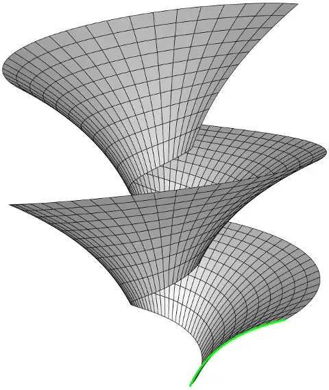

Edit of December 26, 2016: Up to a rigid motion of Euclidean three-space, every self-sliding surface (other than a generalized cylinder) arises as follows.
Fix a parametric curve $\gamma(u) = (r(u), 0, z(u))$ whose image lies in the half-plane $x > 0$, $y = 0$ and whose velocity is non-vanishing; a real number $k$ (the "pitch" or "slope" of a helix); and an arbitrary smooth function $\psi$ (the "gauge"); and put $$ X(u, v) = \left[\begin{array}{@{}c@{}} r(u) \cos(v + \psi(u)) \\ r(u) \sin(v + \psi(u)) \\ z(u) + k(v + \psi(u)) \\ \end{array}\right]. $$ The image of $X$ is the result of sliding the image of $\gamma$ (the green curve below) under the action $$ (x, y, z) \mapsto (x\cos t - y\sin t, x\sin t + y\cos t, kt) $$ of the additive group of real numbers. This action represents rotation about the $z$-axis if $k = 0$ and helical motion about the $z$-axis if $k \neq 0$. (Formally, translation along the $z$-axis arises by letting $k \to \infty$, but I assume you're mostly interested in helical motions.)
A self-sliding surface and a generator
(The gauge function $\psi$ does not change the surface geometrically, but "deforms" the $u$-coordinate curves "internally" by sliding them along the $v$-coordinates curves (circles or helices). If $\psi \equiv 0$, the $u$-coordinates curves ($v$ constant) are plane curves, the images of $\gamma$ under the group action. For some purposes it's more convenient to choose $\psi$ so that the $u$- and $v$-coordinate curves are pointwise orthogonal, as in the diagram below.)
A hyperbolic surface with helical symmetry

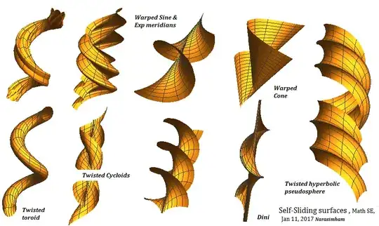

Any arbitrary meridian of a surface of revolution contained in the plane of the axis can be twisted with a screw motion, to obtain these sliding surfaces.
It has a proportionality constant between $\theta$ rotation and $z$ axial progression. We need to simply add one $ h \cdot \theta $ term to the z-coordinate.
Constant Gauss curvature K surfaces are only interesting as, before and after twist, new $K$ comes out a different constant. But it is not otherwise relevant in general imho for this question of OP.
My best guess is that
1) They are Helical Canal surfaces ( not standard nomenclature, we may prepend "general" to it, or const. negative curvature helicoids or Hwang Helicoids ) created by motion of a rigid canal cross section along a helix in which each point describes a helix with constant radial parameter $u$ and variable parameter $\theta$ or arc.
$$ (f(u) \cos v, f(u) \sin v, \, g(u) + h \cdot v) $$
The bi-normal parametrization however does not have much of an advantage over the meridional section definition; in any case the two parametrizations are equivalent.
2) Along parametric lines screw motion all curvatures $ k_n, k_g, K$ are identical.
3) Tangent vector has a constant magnitude (speed) and constant inclination to a fixed direction, here z-axis. Hence $\dfrac{dr}{dz} = \cos \phi \cos \psi = \cos \alpha $ = constant inclination of swept parameter line tangent, to symmetry axis just as it is for a single sheet hyperboloid... Cannot prove this now, although it is necessary and sufficient for this class of surfaces.
4) Parametric lines cut orthogonally,$F=0$.
5) Rotationally symmetric cases are trivial.
A number of meridians are twisted in this manner and their warping effects shown below.
Twisted/Warped/Screw Motion Surfaces
Mathematica program lists meridians chosen and the effect of $ h\cdot \theta $ term.
Clear[X, Z, u, v]; R = 2; r = 1; (* Arbitrary Meridian Screw Motion *)
X[u_] = R Sin[u];
Z[u_] = -R (Cos[u] + Log[Tan[u/2]]); (* Dini with (graphics error) *)
X[u_] = r (u - Sin[u]); Z[u_] = r (1 - Cos[u]);(* Cycloid Axes Interchanged *)
X[u_] = r (1 - Cos[u]); Z[u_] = r (u - Sin[u]); (* Cycloid  *)
X[u_] = (r Cos[u] + R); Z[u_] = r Sin[u]; (* Toroid  *)
X[u_] = (-r u + 2 R); Z[u_] = 2 r - R u;(* Cone *)
X[u_] = Exp[-u/2]; Z[u_] = u;(* Exponential curve *)
X[u_] = Sin[ 2 u] + 3 ; Z[u_] = u; (* Sine curve *)
X[u_] = Sin[ 2 u] + 2 ; Z[u_] = Cos[3 u]; (* Lissajou curve *)
ParametricPlot[{Z[u], X[u]}, {u, -Pi, Pi  },
 PlotLabel -> "PRE-TWIST MERIDIAN"]
h = 0; ParametricPlot3D[{X[u] Cos[v], Z[u] + 0 h v,
  X[u] Sin[v]}, {u, -Pi, Pi}, {v, 0, 3 Pi},
 PlotLabel -> " MERIDIAN SWEPT AROUND Z-AXIS"]
h = 1.5; ParametricPlot3D[{X[u] Cos[v], Z[u] + h v,
  X[u] Sin[v]}, {u, -Pi, Pi}, {v, 0, 3 Pi}, Boxed -> False,
 Axes -> None, PlotLabel -> "POST-TWIST ( h v) REVOLVED MERIDIAN"]
Mechanical fabrication may be also interesting. In a metal cutting machine-shop when meridian shape is supplied in the form of a template mounted on the carriage of a lathe, the operator sets $h$ value from feed/speed ratio forming the needed helix angle to produce helically slidable matching bolt and nut machined surfaces imparting a screw motion to cutting tool. The template block edge holding canal boundary profile has a constant angle to the axis of rotation.
