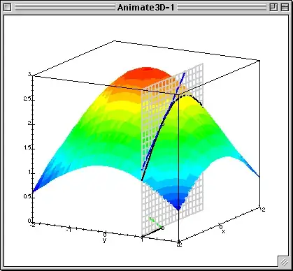

As always, a picture is worth a thousand words: if you can glean the meaning of the directional derivative from this .gif I found online then you may not need to read what I have to say. I hope the animation helps either way.
A gif I found online.
It's worth noting that the little green segment at the base of the figure in this animation is meant to represent the value of the gradient of the function at the given point.

Consider the directional derivative of $f\colon\mathbb{R}^{2}\to\mathbb{R}$ at $\mathbf{x}\in\mathbb{R}^{2}$ in the direction of $\mathbf{v}.$ Its value is equal to the value of the limit: $$\lim_{h\to0}\frac{f(\mathbf{x}+h\mathbf{v})-f(\mathbf{x})}{h}.$$ This can be taken as the definition of the directional derivative; in particular, the above expression turns out to be equal to $\nabla{f}\cdot\mathbf{v}.$ [Note: This equality holds only because $\mathbf{v}$ is a unit vector. If $\mathbf{v}$ is not a unit vector then we need to introduce a scaling factor to account for this.]
Consider the graph of $f,$ that is, the set $$\Gamma = \Gamma(f) = \{(x,y,z)\in\mathbb{R}^{3}: z=f(x,y)\}.$$ This is (more-or-less) a surface in $3$-space. If we look at the points where the graph of $f$ intersects $\mathbf{x}+\Pi,$ then we get a curve in space, which we'll call $\gamma = \gamma(f,\mathbf{v}) = \Gamma\cap(\mathbf{x}+\Pi).$
We can imagine the $z$-axis in $\mathbb{R}^{3},$ which is contained in $\Pi,$ together with the line $\ell = \{k\mathbf{v}:k\in\mathbb{R}\},$ defining a coordinate system on $\Pi$: the vertical axis is given by the $z$-axis, and the horizontal axis is given by $\ell,$ with $0$ at the origin and the values on $\ell$ increasing in the direction of $\mathbf{v}.$
That is, we can imagine the curve $\gamma$ as being the graph of some function $\mathbb{R}\to\mathbb{R},$ except that instead of drawing this graph on the usual $(x,y)$-plane we are drawing it on $\mathbf{x}+\Pi.$
The expression for the directional derivative given as a limit is telling you that the value of the directional derivative (of $f$ at $\mathbf{x}$ in the direction of $\mathbf{v}$) is the slope, under the coordinate system I have described above, of the line which is contained in $\mathbf{x}+\Pi$ and tangent to the curve $\gamma,$ that is, "the slope of the tangent line" in an appropriate plane and coordinate system.
