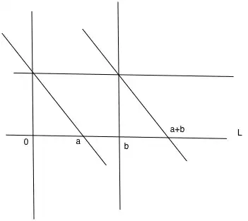

See for instance my answer here. (I remember answering similar questions more than once, but maybe only in comments, which are not searchable.) In that answer I discuss the case of projective transformations while you are asking here about affine transformations, but the proof is the same. The idea, due to von Staudt (it appeared in his 1850 2-volume book on projective geometry), is to do "geometric algebra", i.e. to encode the binary algebraic operations in a field by certain point-line configurations. A good reference is "Foundations of Projective Geometry" by Robin Hartshorne. As for where the topology shows up: One can recover the topology of ${\mathbb R}$ from its ordered field structure which, in turn, can be recovered from pure algebra, as $x^2>0$ for all $x\ne 0$ and vice versa (every positive real number is a square). The situation is drastically different over other fields, e.g. over the complex numbers since one has to take into account the entire absolute Galois group which does not act continuously on ${\mathbb C}$.
The following is a configuration which describes the addition of real numbers.

  • I'm not sure I understand what the claim is. Are you saying that one can some how "realize" $\mathbb R$ within the point-line configurations embedded in the data of the affine lines of $V$? – Dustan Levenstein Nov 29 '16 at 18:25
  • @DustanLevenstein: For the precise proof you have to read Hartshorne's book. The bottom line is that every bijection of $R^n$ ($n>1$) which preserves collinearity is an affine transformations and it is a corollary of the 2nd fundamental theorem of projective geometry. I tried to explain some of the ideas of the proof but that's probably hopeless. – Moishe Kohan Nov 30 '16 at 02:18
  • I'm not asking for the proof; all I'm asking you to do is explain what the sentence "encode the binary algebraic operations in a field by certain point-line configurations" means. Precisely what algebraic operations in what field are we talking about? We already know what $\mathbb R$ is, so I'm guessing you're talking about some realization of $\mathbb R$ in terms of the incidence structure, but I can only guess with what you've written. – Dustan Levenstein Nov 30 '16 at 02:27
    @DustanLevenstein then indeed, these are the binary operations of the field of real numbers (addition and multiplication). Von Staudt considers an affine line in the affine plane with two points marked on the line (which will be 0 and 1) and a certain collection of auxiliary points and lines in the plane. Given this data he defines geometrically two functions from the square of the affine line to the affine line. These functions are then shown to coincide with the binary field operations. – Moishe Kohan Nov 30 '16 at 02:50
    Once you know this, given a bijection $b$ of the plane preserving collinearity as well as the two marked points on the distinguished affine line L, it follows that the bijection $b$ restricted to $L$ is a field automorphism. Then use the fact that the field of real numbers has no nontrivial automorphisms. Hence the bijection restricts to the identity on $L$. This is the key part of the proof. – Moishe Kohan Nov 30 '16 at 02:54
