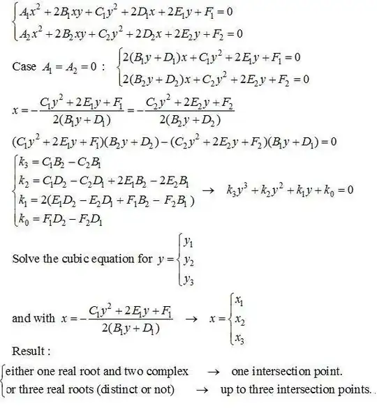

The case $A_1=A_2=0$ leads to a cubic equation. They are at least one or up to three intersection points :
The general case, valid not only for two hyperbolas but for two quadratic curves, leads to a quartic equation, so from zero up to four intersection points.
JJacquelin

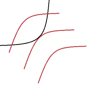

The solution is voluminous, found by Cramer's Rule solving for 2 unknowns from 2 equations. Roots are as quadratic equation depending on sign of quantity under the radical $$ (-2 B2^2 C1 D1 + 2 B1 B2 C2 D1 + A2 C1 C2 D1 - A1 C2^2 D1 + 2 B1 B2 C1 D2 - A2 C1^2 D2 - 2 B1^2 C2 D2 + A1 C1 C2 D2 + A2 B2 C1 E1 - 2 A2 B1 C2 E1 + A1 B2 C2 E1 + A2 B1 C1 E2 - 2 A1 B2 C1 E2 + A1 B1 C2 E2)/(-4 A2 B1 B2 C1 + 4 A1 B2^2 C1 + A2^2 C1^2 + 4 A2 B1^2 C2 - 4 A1 B1 B2 C2 - 2 A1 A2 C1 C2 + A1^2 C2^2) + ..... + \sqrt {...} $$ EDIT 1: Considering a single brach it may be like one of three situations:
Hyp ntrxn
But for two branches, there is a situation of double the number of roots/intersections as may be in a quadratic equation.
