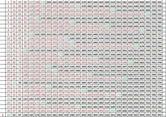

So instead, I made a chart where (for my example problem) there's 29 rows and the chart is composed of all the counting numbers (one after the other). This makes each column 29 apart. Then it's elimination of all representable by finding the first number in each row divisible by 25 (in green). It can then be seen each number to infinity for that row thereafter can be created by adding more 29's (so all green numbers and those crossed off are representable). So in this chart, the red numbers are not representable, and the highest is 671 (which correlates to $ab-a-b = 25*29-25-29 = 671$). Also, from this chart I can conceptually see that all numbers can be created after a certain number of unrepresentable, which was something I was originally having hard time seeing. (They are represented by the ... for infinity).
