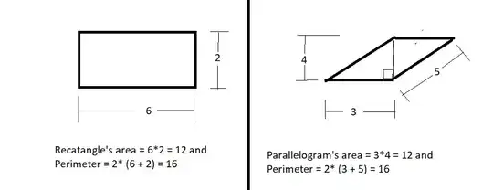

Yes, it is possible, though the solution is arbitrary.
See the attached image. enter image description here

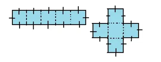

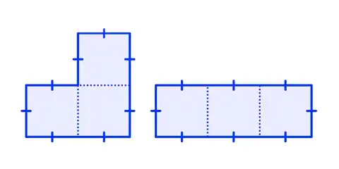

Duly acknowledging @Blue 's solution, it seems arbitrarily many such solutions might be possible, one being here, below:
Can this be extended, perhaps in methodical manner?
