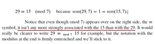

I am reading Notes of Mathematics for Computer Science(MIT 6.042J). And I'm stuck in the Modular Arithmetic Section which I mark with a RED LINE.
I want to know what is trying to say. Is it trying to say that $(\operatorname{mod} 7)$ is neither associated with $29$ nor $15$? Here the Picture of that Equation

  • The author is probably trying to help their readers. People with programming background often associate mod with the remainder operation. That is more accurately called binary mod. That is a process that takes two integers as inputs and gives a third integer as an output. Such as $7\bmod 3 =1$. The congruence is semantically a comparison operator that takes two integers as inputs and gives a boolean (yes/no) output. Actually there is one comparison operator for each non-zero integer $m$. The $\pmod m$ just identifies which comparison operator is meant. – Jyrki Lahtonen Aug 29 '16 at 19:50
    And, yes, he is trying to say that $\pmod 7$ is associated to neither $29$ nor $15$. If I need to make a pick I would say that it is associated to both $29$ and $15$ equally. If I remember C-notation correctly, then for positive integers we have $$a\equiv b\pmod m$$ if and only if $$(a%m)==(b%m)$$ Observe the double equality sign. This is a comparison operator. CAVEAT: Many programming languages and/or processors define $%$ differently for negative inputs, and the above needs modifications. – Jyrki Lahtonen Aug 29 '16 at 20:01

This is largely a matter of finding whatever focus helps you to understand the process going on here. The $\pmod 7$ is describing what kind of equivalence ($\equiv$) we're using - so $\pmod 7$ is not "acting on" either of the numbers in reality. To bring the $\equiv$ and the $\pmod 7$ together, you could imagine that the comparator is written as $\color{red}{\underset{\bbox[2px]{\bmod 7}}{\equiv}}$ or even $\color{red}{\underset{\bbox[2px]{7}}{\equiv}}$ with reasonable clarity, if that is a useful way of understanding for you.
So what does $29 \equiv 15 \pmod 7$ (or in the above variant notation $29 \color{red}{\underset{\bbox[2px]7}{\equiv}} 15$) actually mean?
  • $29$ and $15$ sit in the same relation to the nearest respective multiples of $7$ - that is, $29$ is the same position in $(28, 35)$ as $15$ is in $(14,21)$
  • $(29-15)$ is divisible by $7$ (the two numbers are separated by an integer mulitple of $7$)
  • $29$ and $15$ have the same remainder when divided by $7$ (although for negative numbers this can be confusing/ambiguous).

The author is talking about the placement of the phrase "(mod 7)". What the expression $29\equiv15$ (mod 7) is really saying is that 29 (mod 7) and 15 (mod 7) are equivalent. The placement of the "(mod 7)" after the 15 is not modifying the 15 alone, but the entire equivalent statement, i.e., $\left[29\equiv15\right]$ (mod 7). The author is really complaining about the way it is conventionally written, but is unable to do anything about it because the convention is "firmly entrenched."
In other words, don't worry about it. The author is just whining about the conventional notation, but it will not affect the overall mathematics.

It seems the point of the remark is to emphasize the symmetric property of the congruence relation i.e. $\,a\equiv b\iff b\equiv a\pmod m.\,$ This is not true for the operator mod, e.g we have $\,15\equiv 1\pmod 7\,$ and $\, (15\bmod 7) = 1\,$ and $\,1\equiv 15\pmod 7\,$ but $\ (1\bmod 7) \neq 15.\,$
The operational mod is antisymmetric since it converts its argument to normal form. The relational mod has no such preference, which often makes it more flexible in many contexts, e.g. $\,{\rm mod}\ 10\!:\,\ 9\equiv -1\,\Rightarrow\, 9^{2n}\equiv (-1)^{2n}\equiv ((-1)^2)^n\equiv 1^n\equiv 1,\,$ where we have used the flexibility of the congruence relation to choose a rep $\equiv 9\,$ which makes the power computation trivial.

It is trying to say that we identify all numbers modulo $7$. So $15$ isn't any more equal (equivalent) to $7$ than $29$ is. In other words, $$29\equiv 15\equiv 1 \bmod 7, $$ so they are all equivalent to $1$. Perhaps the equal sign is clearer. In the ring $\mathbb{Z}/7\mathbb{Z}$, we really have equality: $29=15=1$. On the other hand, in the ring $\mathbb{Z}$, these numbers are not equal, but only equivalent modulo $7$.

Because of some early programming languages and unfortunate choices of terminology, programmers often interpret "mod" as the remainder operator; e.g. 29%7 is the value 1.
But in mathematics, mod is an equivalence relation, which is, under a rather literal translation from mathematics to python:
def mod(n):
    return lambda x,y: (x-y) % n == 0
rel = mod(7) # Obtain the equivalence relation "mod 7"
rel(29, 15) # returns True
The text is trying to make sure you correctly interpret the phrase
$$ 29 \equiv 15 \pmod{7} $$
as
rel(29,15)
and not as
29 == 15 % 7
