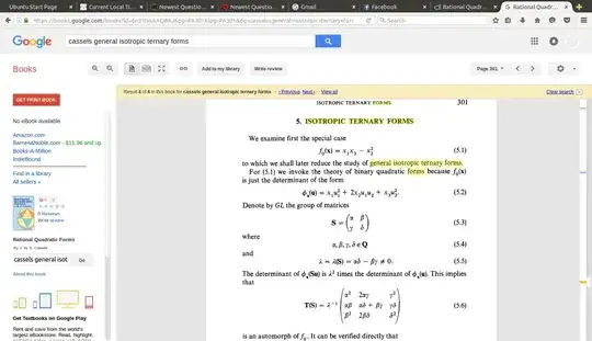

Here is page 301 in Cassels. He switches $\beta, \gamma$ in the 3 by 3 matrix, compared with what I typed above.
