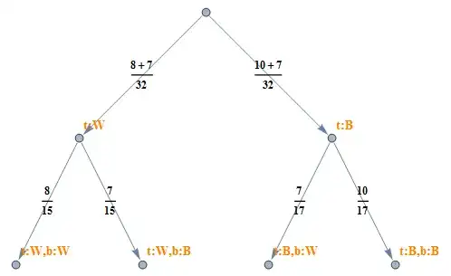

I have a homework question that reads:
You have a deck of $16$ cards, with:
$4$ cards that are white on both sides;
$7$ cards that are white on one side, black on the other;
$5$ cards that are black on both sides.
The cards are shuffled and randomly flipped. You draw one card from the deck and look only at one side of it.
  • (a) Draw a tree diagram with the probabilities of all possible card types. Hint: Your tree should have two levels, one for the color of the top of the card, and one for the color of the bottom card.
  • (b) What is the probability that the top of your card is black?
  • (c) If the top of your card is black, what is the probability that the bottom is white?
  • (d) If the top of your card is white, what is the probability that the bottom is white?
Now, here has been my approach thus far:
first, I figured out how many total white sides and black sides there are:
White sides $= 4 \times 2 + 7 = 15$
Black sides $= 5 \times 2 + 7 = 17$
Total sides $= 32$
Probability for top side being white $= 15/32 = 0.46875$
Probability for top side being black $= 1 - 15/32 = 0.53125$
Now, my problem is there is this $P(A | B)$ formula thing that I'm supposed to use to get the next level ones, but I don't know how to do that, so I skipped the probabilities for the second level in the tree for a bit.
I went on to (c), where I said the probability was $7/12$, or about $0.58333$, because if your top is black, either you have a full black card (of which there are $5$), or you have a mixed card (of which there are $7$). You're looking for the probability of a mixed card, so you have a total of $7$ winning picks out of a total $12$ picks ($7 + 5$). I did a similar thing for (d)
Then I went back and filled in the tree by doing the probability of the top side (say the top is black, which is $0.53125$) times the probability of the bottom for that branch (say bottom is white (top has already been black), so that is $0.58333$). So I went $0.53125 \times 0.58333 = 0.309894$, and did $0.53125 - 0.309894$ to get the probability of a full black card.
My question is, how can I fill out the probability tree by using this $P(A|B)$ thing? I know that the formula for $P(A|B)$ is $P(A \cap B) / P(B)$. The thing is, I was getting an obviously wrong probability.
Let $B$ be the event that the top of the card drawn is black.
Let $A$ be the event that the bottom of the card drawn is white.
$P(A|B) = P(A \cap B) / P(B) = (7/16) / (17/32) = 14/17 = 0.823529\ldots$? what?
I did $7/16$ because that's the percentage of getting a mixed card ($A \cap B$), right? I don't understand
UPDATE:
Actually, $7/16$ should be $7/12$ right? Because we don't need to have the $4$ full whites in there. Now, $7/12 \times 17/32 = 0.309894$, which is the correct answer I believe. But isn't it $P(A \cap B) / P(B)$?
When shuffling and flipping at random, each of the following 32 configurations is equally likely: $$ 8: (W,W), \quad 7: (W,B), \quad 7:(B,W), \quad 10:(B,B) $$ where the first letter denotes the color of the top side of the card, and the second denotes the color of the bottom side. The top of the first card is black in $10+7$ cases out of $32$. Thus, for b), the probability is $\frac{17}{32}$. Out of these $17$ cards, $7$ will have white bottom side, and $10$ will have black bottom side. Continuing in this manner produces the following tree diagram:
Now answers to remaining questions can be easily read off from this diagram.
Sasha
  • 70,631
  • Thank you very much Sasha! I wish I could mark two as the correct answer, as I used both of your explanations to finally break through my mental block on this one. Thanks! –  Sep 02 '12 at 15:45
