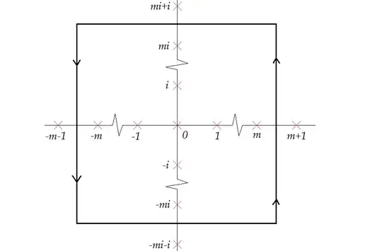

This aproach requires simple techniques from complex analysis - let us define a meromorphic function $f(z)$ :
$$f(z) = \frac{\cot\pi z}{\sinh^2\pi z}$$
This function has poles $z_k$ at $z=n$ and $z=ni$, where $n\in\mathbb{Z}$
Consider a square contour in the picture below $(m\in\mathbb{N})$
By residue theorem :
$$\oint _{\gamma} f(z)\, \mathrm{d}z=2\pi i\sum\mathrm{Res}_{z=z_k}{f(z)}\tag{1}$$
For the residues we have :
$$\begin{align} & \mathrm{Res}_{z=n}{\frac{\cot\pi z}{\sinh^2\pi z}} = \frac{1}{\pi\sinh^2\pi n} \\ \\ & \mathrm{Res}_{z=ni}{\frac{\cot\pi z}{\sinh^2\pi z}} = \frac{1}{\pi\sinh^2\pi n} \\ \\ & \mathrm{Res}_{z=0}{\frac{\cot\pi z}{\sinh^2\pi z}} = -\frac{2}{3\pi} \end{align}$$
When $m\rightarrow\infty$ we have
$$\frac{\cot\pi (x\pm (mi+\frac12))}{\sinh^2\pi (x\pm (mi+\frac12))}\rightarrow \frac{\mp i}{\cosh^2\pi x}$$
Since integrals along the sides vanishes as $m\rightarrow\infty$ we rewrite $(1)$ using residues taking the limit as $m\rightarrow\infty$:
$$-2i\int_{-\infty}^\infty\frac{\mathrm{d}x}{\cosh^2\pi x}=2\pi i\left(-\frac{2}{3\pi}+\frac{4}{\pi}\sum_{n=1}^\infty\frac{1}{\sinh^2\pi n}\right)$$
Immediately since $\int_{-\infty}^\infty\frac{\mathrm{d}x}{\cosh^2\pi x}=\frac{1}{\pi}\tanh\pi x\bigg{|}_{-\infty}^\infty=\frac{2}{\pi}$ after simple manipulations we get the desired result :
$$\sum_{n=1}^{\infty}\frac{1}{\sinh^2\!\pi n}=\frac{1}{6}-\frac{1}{2\pi}$$
