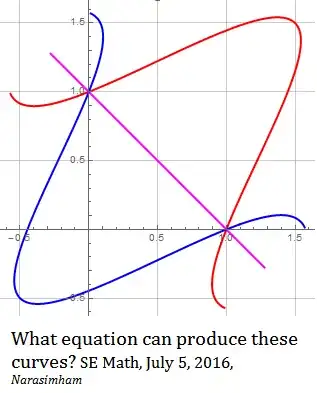

Does an equation exist that can produce the curves shown in the attached image, by varying a single variable?
1Do you mean in principle, or are you asking for specific examples? – Christopher King Jul 05 '16 at 03:17

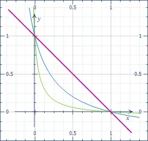

Consider the equilateral hyperbola $xy=1$ and map the points $(1,0)$ and $(0,1)$ to two symmetrical points on the hyperbola $(t,t^{-1})$ and $(t^{-1},t)$ by translation/scaling (as if you were zooming in).
$$(x(t-t^{-1})+t^{-1})(y(t-t^{-1})+t^{-1})=1.$$
The straight line corresponds to two infinitely close points, $t=t^{-1}=1$, which is a degenerate case of the equation.
Previous answer:
You can think of a pencil of parabolas, $y=\frac1{\sqrt2}+\frac\lambda{\sqrt2}(2x^2-1)$, which you rotate by $45°$ right, giving
$$x+y=1+\lambda\left((x-y)^2-1\right).$$
You can solve the quadratic equation for $y$.
1If I take $(x,y)$ to be $(1,0)$ or $(0,1)$, it seems to me that your equation is not satisfied. – Jeppe Stig Nielsen Jul 04 '16 at 21:51
This has become promising, since the it goes through the two points as required, and is has the symmetry that swapping $x$ and $y$ leaves the equation unchanged. However for some values of $\lambda$ it may look different than expected. Like when $\lambda$ is close to $1$, the vertex of the parabola is close to the origin, and the parabola (after rotation) crosses the coordinate axes in the "opposite" direction, I think. – Jeppe Stig Nielsen Jul 04 '16 at 22:34
@JeppeStigNielsen: the exponent $2$ can be lessened, but at some point we are lacking curve specifications. – Jul 04 '16 at 22:36
At what value of $\lambda$ will the two axes be tangents at the two "fixed" points? – Jeppe Stig Nielsen Jul 04 '16 at 22:40
Your current image "before rotation" is also magnified by a factor $\sqrt{2}$ compared to the image of the question. The biggest isosceles right triangle has side lengths $1,1,\sqrt{2}$ in the correct solution, and side lengths $\sqrt{2},\sqrt{2},2$ in the current image of this answer. One can easily confuse oneself with this. However, your formula $$x+y=1+\lambda\left((x-y)^2-1\right)$$ is good, as I said, because it is symmetric in swapping $x$ and $y$ and is correct for $(1,0)$ and $(0,1)$. It might still be interesting to see another family of curves, maybe hyperbolas instead of parabolas. – Jeppe Stig Nielsen Jul 04 '16 at 22:54

Try a superellipse: $|x|^a + |y|^a =1$ with $0 <a \le 1$.
- 216,483
3Yes, but that curve will not intersect (pass through) the coordinate axes and continue into the 2nd/4th quadrant as shown in the image. But maybe that was not a requirement. – Jeppe Stig Nielsen Jul 04 '16 at 22:02
@JeppeStigNielsen You could try analytic continuation, or simply remove the $|\cdot|$ – Tobias Kienzler Jul 05 '16 at 06:01
@TobiasKienzler The superellipse with $a<1$ has a cusp at the point in question. It is not meeting the axis at a non-zero angle like in the drawing of the question. – Jeppe Stig Nielsen Jul 05 '16 at 09:11
