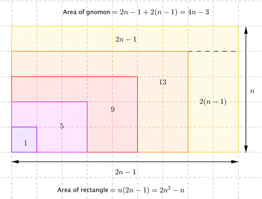

Follow the rainbow!
$$ \Large \color{PaleVioletRed}1 + \color{DarkViolet}5 + \color{DodgerBlue}9 + \dots + \color{LightCoral}{(4n-3)} = n(2n-1) = 2n^2-n$$

    Quite the most unexpectedly beautiful answer I’ve seen on any Stackexchange site, ever! Whimsical, pretty, and mathematically lucid, all at the same time. – Peter LeFanu Lumsdaine May 28 '16 at 22:30
    A fantastic demonstration that geometric and pictorial methods are still a very concise and complete way of proving results. – Nij May 29 '16 at 08:07
    I agree that this is a neat, concise answer. However, for it to be an actual proof I'm sort of missing an argument as to how we know that the geometric interpretation is even correct (for arbitrary n). – Ingo Bürk May 29 '16 at 14:56
  • @IngoBürk I sketch how to mechanically derive such proofs in my answer, using a 2-dimensional form of telescopy, This allows us to view the rectangle (or its area) as the sum of the successive differences of the preceding rectangles, so we can view each rectangle as inductively built layer-by-layer - like a 2D printer building it by applying each differential (border) layer to increment rectangle $R_n$ to $R_{n+1}$. The incremental (border) layers are the arch-shaped regions formed by the same-colored squares above (of area $4n-3).\ \ $ – Bill Dubuque May 29 '16 at 16:12
    @IngoBürk: I would read it as describing a partition of the set $[1…n] \times [1…2n-1]$, along with a numbering of the partition classes, such that the $i$th class contains $4i-3$ elements. (Here $[a…b]$ denotes the “integer interval” ${ x \in \mathbb{Z}\ |\ a \leq x \leq b }$.) Filling in the details of this sort of argument is an interesting and non-trivial exercise if you haven’t before; once you’ve done it a couple of times, it quickly becomes routine. – Peter LeFanu Lumsdaine May 30 '16 at 10:16
  • @Lynn Out of curiosity, how did you produce the image? – ColinK May 30 '16 at 12:09
    @ColinK: Google Spreadsheets! http://puu.sh/pagwd/0fd85b246c.png – Lynn May 30 '16 at 13:15
  • @PeterLeFanuLumsdaine Could you please provide details of the alternative interpretation that you have in mind. I cannot (uniquely) infer them from what you wrote. – Bill Dubuque May 30 '16 at 18:29
    @BillDubuque: ok! Actually I’ll deviate slightly from my previous comment — instead of $[1…n] \times [1…2n-1]$, set $m = n-1$ and work with $X = [0…m] \times [-m…m]$. Take the partition on $X$ induced by the function $f : X \to [0…m]$ sending $(i,j)$ to $\max(|i|,|j|)$. Now $|f^{-1}(k)| = 4k+1$ (one can enumerate it explicitly), so $n(2n-1) = (m+1)(2m+1) = |X| = \sum_{k=0}^m |f^{-1}k| = \sum_{k=0}^{m} 4k+1 = \sum_{k=1}^n 4k - 3$. $\qquad \square$ – Peter LeFanu Lumsdaine May 30 '16 at 19:17
  • I've been waiting for a day where I can actually understand one of the answers given on mathematics. That day has finally arrived. – Pharap May 31 '16 at 01:25
  • @IngoBürk +1 I decided it was simplest to say the top is $2n-1$ and the remaining sides are $n-1$, leading to $2n-1+2(n-1)=4n-3$. – Mark Hurd May 31 '16 at 03:33

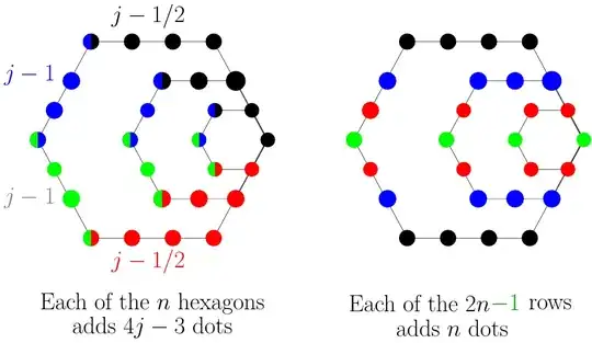

By counting dots (of Hexagonal number) in two ways.
On the left: there are four "outer" sides of each hexagon $j = 2, \dots, n$, where each side has $j$ dots but 3 of them are shared, in addition the trivial hexagon $j=1$ is one dot. Therefore, in total there are $\sum_{j=1}^n4j-3$ dots.
On the right: there are $2n-1$ rows (since a hexagon has both top and bottom sides, except the trivial case), and each row adds $n$ dots. Hence $n(2n-1) = 2n^2-n$ dots.
*Despite being geometric, induction may well be needed to justify the counting arguments, as Bill Dubuque noted.

Which converts the sum to the sum of a collapsing series.
This implies Lynn's graphical proof shown below and, though it still requires induction, I thought it shows an interesting way to compute sums.
