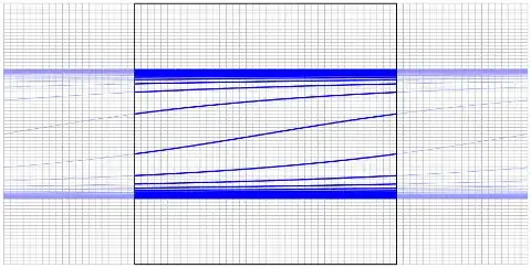

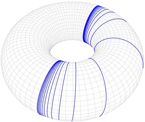

The decomposition $\Reals^{2m} \simeq (\Reals^{2})^{m}$ gives an orthogonal product of $m$ circles of radius $\frac{1}{\sqrt{m}}$ in the unit sphere $S^{2m-1}$. The Euclidean line $\Reals$ can be isometrically embedded into a flat $S^{1} \times S^{1}$ (with circles of equal, arbitrary positive radius $r$). For example, take an arclength parametrization of the path $$ t \mapsto (t, r\arctan t), $$ whose image lies in $\Reals \times (-\frac{1}{2} \pi r, \frac{1}{2} \pi r) \subset \Reals \times \Reals$:
Embedding the line in a torus, unwrapped
Divide by the square lattice $2\pi r\Int \times 2\pi r\Int$ to get an isometric embedding into a square torus. (The square in the preceding diagram is a fundamental domain for the lattice.)
Embedding the line in a torus, wrapped

    Right, with one terminological quip: Usually, an "embedding" is understood as a homeomorphism to its image. The maps you are constructing will not be homeomorphisms to their images (in the sphere) if the Riemannian manifold is noncompact (at least in general). What you getting are isometric injective immersions. One needs to work a bit more to get embeddings. The trick is to first construct an isometric embedding $R\to T^2$ (not given by a line with irrational slope). – Moishe Kohan May 19 '16 at 21:11
  • @studiosus: Yes, that was sloppy of me. You're thinking of, e.g., taking an arc-length reparametrization of $t \mapsto (t, \arctan t)$ and wrapping it around a product of unit circles, so the ends of $\Reals$ accumulate on a pair of parallel circles? – Andrew D. Hwang May 19 '16 at 22:00
    Andrew: That would work. I was thinking about a double spiral which is an isometric embedding of $R$ into $R^2$ with bounded image (contained in a small disk), like an Euler spiral. Then embed the small disk in the 2-torus. – Moishe Kohan May 19 '16 at 22:08
  • Thanks for your comments! I have tried to implement carefully your ideas, but got stuck at some point. I have two difficulties; 1) We need to prove that the image of the Euler curve can be arbitrarilly small. (This is because when our circles gets smaller radii, their volume decreases, hence the disks we can isometrically embedd in them also decrease in diameter). "See my attempted proof of Lemma1 below" 2) I am having hard time convincing myself formally this is actually an embedding (and not just a smooth isometric immersion). – Asaf Shachar May 20 '16 at 16:27
  • Since this is all a bit of a diversion from the original question, I have opened a new one here: http://math.stackexchange.com/questions/1793159/proving-eulers-spiral-is-an-isometric-embedding-with-bounded-image. Can you help? Thanks! – Asaf Shachar May 20 '16 at 16:27
