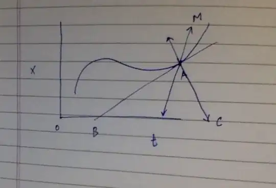

I have just started studying calculus for the first time, and here I see something called a tangent. They say, a tangent is a line that cuts a curve at exactly one point. But there are a lot of lines that can cut the same point just like shown in the picture- enter image description here
WHY aren’t we saying that lines M and C are also tangents?
What is the real definition of a tangent line?
“ A tangent line is a line which passes through two infinitesimally close points” Is this definition correct? Thanks!

  • Aaryan, intuitively, (1) it couldn't be simpler. notice your "incorrect" tangent M. it crosses back inside the curve. imagine another "incorrect" tangent, very close to B. very simply, if you *look really close* ("with a magnifying glass") the incorrect tangent would also cross over, like M. that's all there is to it. – Fattie Apr 19 '16 at 13:24
  • Aaryna intuitively (2) it couldn't be simpler. Imagine a curved piece of wood, and you hold a straight edge against it. You're at point "A" let's say. now you twist the straight edge a little, continuing to press against the wood curve. what happens? It is now, obviously, impossible that it can touch at A it will be touching somewhere else along a little from A. As you '"roll" the straight edge along, it's absolutely impossible that it doesn't change angle. (it is "pushed up" by A which is now "higher") At any point "A" it can ONLY be at a certain angle. – Fattie Apr 19 '16 at 13:28
  • if you're at "A" and you say "try to change the angle of the straight edge, but, keep it at 'A'" it's obviously impossible to do that (unless you deform the wood!). it's that simple. – Fattie Apr 19 '16 at 13:29

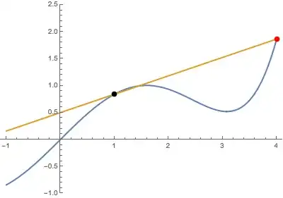

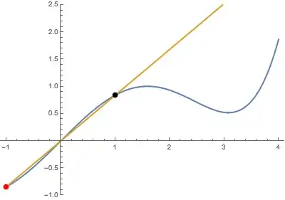

Animations showing that the limit of a secant as the variable point tends towards a fixed point becomes the tangent line.
First, when the variable point (in red) approaches the fixed point (in black) from below:
Second, when the variable point approaches the fixed point from above:
In both cases, the secant line becomes the same tangent line. This suggests that the derivative is well-defined at the black point (which is highlighted in green when tangency occurs).
Formally, then, this gives us a definition of the derivative as follows. For a real-valued function $f(x)$, the derivative at $x = a$ is the limit of the slope of the secant line through two points $$P_a = (a, f(a)), \quad P_b = (b, f(b))$$ as $b$ approaches $a$, whenever such a limit exists. Since the slope is simply $$\frac{f(b)-f(a)}{b-a},$$ we then have $$f'(a) = \lim_{b \to a} \frac{f(b) - f(a)}{b-a}.$$ The equation of the tangent line at the point $P_a$ is therefore $$y - f(a) = f'(a)(x-a),$$ if the line does not have infinite slope; otherwise $1/f'(a) = 0$ and we can write the equation of the tangent line as $x = a$.

  • But in your animation,the secant line DOES become the tangent line?So why do we use the word approach using limit?Shouldn't the slope be f(b)-f(a)/b-a when b=a? – a_i_r Nov 12 '20 at 15:51
  • @a_i_r that would be because you would simply be dividing by zero then, no? – AdamLee123 May 25 '23 at 21:43

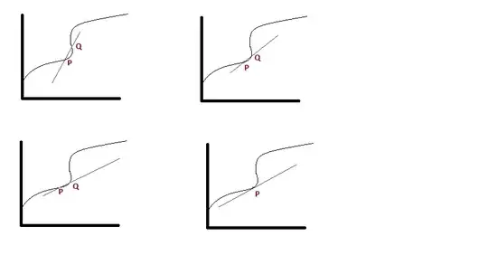

Consider a curve $\gamma\subset{\mathbb R}^2$ passing through the point $O=(0,0)$. When should we accept the line $y=0$ as tangent to $\gamma$ at $O$? The natural geometric conditions are that (i) near $O$ the curve $\gamma$ can be described by an equation of the form $y=f(x)$ with $f$ continuous near $0$ and $f(0)=0$, and that (ii) for any however small $\epsilon>0$ "the curve $\gamma$ lies ultimately within the double cone $|y|\leq\epsilon|x|$ when $x\to 0$". Together this is tantamount to saying that $$f'(0)=\lim_{x\to0}{f(x)\over x}=0\ .$$ This would include the cases $y=x^3$ (here $\gamma$ does not stay one one side of the tangent) as well as more pathological cases like $f(x):=x^2\sin{1\over x}$, but not $y=|x|$. In the example $y=|x|$ the line $y=0$ is a supporting line of the graph, but not a tangent.
  • What about the cube root function at $x=0$? It is not differentiable but has a vertical tangent line. – John Douma Apr 19 '16 at 14:50
    I've downvoted this answer because, while technically correct, it is far too advanced for a question whose opening sentence is "I've just started studying calculus for the first time..." – S. G. Apr 19 '16 at 16:36
  • @JohnDouma: My answer tries to convey a calculus-free idea of what a tangent line is. I'm describing under what circumstances the line $y=0$ could be called a tangent to a curve passing through $(0,0)$. – Christian Blatter Apr 19 '16 at 18:31
  • @S.G.: Fine. What is your your idea what a "tangent" to a curve $\gamma$ at a point $P\in\gamma$ is? – Christian Blatter Apr 19 '16 at 18:35
  • As I said, there is nothing really technically wrong with this answer, but it is far too advanced for a beginning student. It resolves to a jumble of symbols that the student has most likely never encountered before and therefore imparts very little information, which makes it a poor answer to this specific question. – S. G. Apr 20 '16 at 17:16

$ M,C$ are not tangents. But $B$ is a tangent .
With respect to rotating arrow lines you drew, $B$ has zero or minimum slope and $C$ has maximum or infinite slope.
Like imagine what you drew was an orange you are cutting with a knife all the orange will be cut for $C$ arrow direction but only a thin 1 inch round circle around tangent cut along $C$ direction.

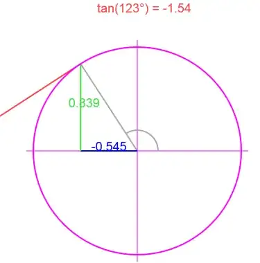

Tangent is the ratio between the opposite and the adjacent side of a right triangle. If a circle is drawn around the triangle with the diameter of the hypotenuse of the triangle, a line perpendicular to the hypotenuse at the point where it intersects the circle is tangent to the circle, i.e. it passes through one and only one point on the circle. enter image description here

It might help to look at the definition of a 'secant' line first. A secant line is basically just a line which passes through the graph of a function at two points. To find the tangent line at a specific point (x,y), we look at all of the secant lines containing (x,y). In other words, fix that point and let the second point vary along the curve.
Now, the tangent line is just the limiting line as the second point gets very close to our fixed point (x,y). In most functions, this behaves as others are saying - that is, that the function (close to where we're looking) is all on one side of the tangent line and only our point (x,y) touches the line. There are, however, cases like $x^3$ at (0,0) where the function may split to both sides.
The tangent line at point P is best defined as a limit position of a secant line that crosses the curve at points P and Q, as the point Q approaches P along the curve.
No coordinate system, no coordinates, no calculus (well, almost).
And it works in 3D and higher dimensions as well. :)

You are operating with the incorrect definition for a tangent. Your statement "They say, a tangent is a line that cuts a curve at exactly one point" is flaw, this is not the definition of a tangent. The correct statement is that a touches a curve at a point and does NOT cross the curve at that point. If a curve is considered to have two sides, a tangent is a line which would approach the curve at a point such that meets the curve but does not cross the curve at that point. There are an infinite number of lines that can cross the curve, but at any point there will only be one which can touch it without crossing it, and this is the tangent at that point.
There is no need to define the tangent in terms of calculus, rather, this definition is the basis for many concepts in calculus, attempting to use calculus to define it would be circular reasoning. Rather, your issue is with an incorrect stating of the definition which could never be reconciled to what a tangent actually is. Note also, this does not mean that the tangent cannot cross the curve, it can, and often does for complex curves. It simply cannot cross the curve at the tangent point.
