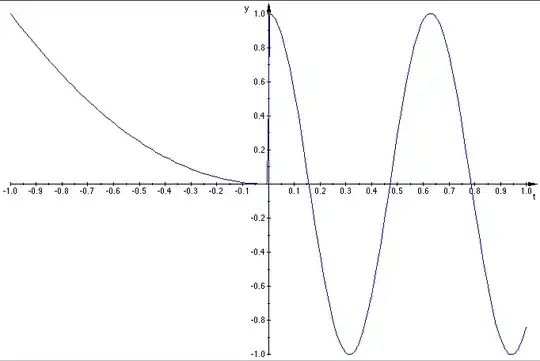

Let's illustrate this with an example : $x\mapsto x^2$ for negative $x$ and $x\mapsto \cos(10 x)$ for positive $x$ illustrated with $n=1000$ and $n=100$ :
f(t)=t^2/(1+exp(1000*t))+cos(10*t)/(1+exp(-1000*t)
n=1000
f(t)=t^2/(1+exp(100*t))+cos(10*t)/(1+exp(-100*t)
n=100

    that's pretty darn badass dude. it's not perfect but i can adapt. many thanks. – guest Jul 24 '12 at 19:52
  • @user35945: glad it helped! One of the possible problems is exponential overflow or underflow (i.e. the resulting function should be tested for the minimal an maximal value allowed). – Raymond Manzoni Jul 24 '12 at 20:40
