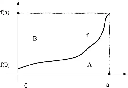

Geometrically, this equality represents:
The area of the rectangle with side lengths $a\times f(a)$ is equal to the sum of the area below the graph of $f(x),\,x\in[0,a]$ and the area above the graph of $f(x)$, which completes the rectangle. The later area is in fact the area below the inverse of $f$ in the interval $[0,f(a)]$.
Addition: The minimal requirements on the function $f$ are to be continuous and injective (differentiability is not needed), so that $f^{-1}$ makes sense. The condition of continuity is necessary, because otherwise it might happen that the range of $f$ is a strict subset of $[f(0),f(a)]$ and that $f^{-1}$ is not defined on a whole subinterval of $[f(0),f(a)]$ and so the integral $\int\limits_{f(0)}^{f(a)}{f^{-1}(y)dy}$ would not make sense. Now, because $f$ is continuous and a bijection from $[0,a]$ to $[f(0),f(a)]$ it follows that $f$ is strictly monotone.
Case 1 ($f$ is increasing) (look at the picture of Nikolaos Skout):
For each point $M(x_M,y_M)$ in the rectangle $a\times f(a)$ we have that either $y_M>f(x_M)$ ($M$ is above the graph of $f$, i.e $M\in B$) or $y_M\leq f(x_M)$ ($M$ is below the graph of $f$, i.e $M\in A$). Therefore $A\cap B=\emptyset$ and $A\cup B=$ the rectangle $\{a\times f(a)\}$ $\quad\quad(*)$.
Also we have that according to the Rieman integral ($f$ and $f^{-1}$ are integrable as continuous functions defined on fintie intervals) that $\mu(A)=\int\limits_{0}^{a}{f(x)dx}$ and $\mu(B)=\int\limits_{f(0)}^{f(a)}{f^{-1}(y)dy}$, where $\mu$ denotes area. Now according to $(*)$ it follows that $\mu(\{a\times f(a)\})=\mu(A)+\mu(B)$.
Case 2 ($f$ is decreasing) is done analogously, having in mind that $\int\limits_{f(0)}^{f(a)}{f^{-1}(y)dy}$ is a negative value, because $f(0)>f(a)$.

A geometric approach is as follows: the integral
$\displaystyle \int_{0}^{a}f(x)dx$ is represented by the region A and the
$\displaystyle \int_{f(0)}^{f(a)}f^{-1}(x)dx$ is represented by
the region B. Of course the sum of the areas of the above regions equals the whole area, that is af(a), as desired.
