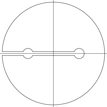

Let's attack the inner integral. We may do this using the residue theorem. Consider the following contour integral:
$$\oint_C \frac{dz}{(1+u^2 z^2) \sqrt{z^2-1}} $$
where $C$ is the following contour:
with the circular-arc detours about the branch points at $z=\pm 1$ have radius $\epsilon$ and the outer circle has radius $R$. The contour integral is equal to
$$\int_{-R}^{-1-\epsilon} \frac{dx}{(1+u^2 x^2) \sqrt{x^2-1}} + i \epsilon \int_{\pi}^0 d\phi \, e^{i \phi} \frac1{[1+u^2 (-1+\epsilon e^{i \phi})^2] \sqrt{(-1+\epsilon e^{i \phi})^2-1}} \\ + e^{-i \pi/2} \int_{-1+\epsilon}^{1-\epsilon} \frac{dx}{(1+u^2 x^2) \sqrt{1-x^2}} + i \epsilon \int_{\pi}^{-\pi} d\phi \, e^{i \phi} \frac1{[1+u^2 (1+\epsilon e^{i \phi})^2] \sqrt{(1+\epsilon e^{i \phi})^2-1}} \\ + e^{i \pi/2} \int_{1-\epsilon}^{-1+\epsilon} \frac{dx}{(1+u^2 x^2) \sqrt{1-x^2}} + i \epsilon \int_{2 \pi}^{\pi} d\phi \, e^{i \phi} \frac1{[1+u^2 (-1+\epsilon e^{i \phi})^2] \sqrt{(-1+\epsilon e^{i \phi})^2-1}} \\ +\int_{-1-\epsilon}^{-R} \frac{dx}{(1+u^2 x^2) \sqrt{x^2-1}} +i R \int_{-\pi}^{\pi} d\theta \, e^{i \theta} \frac1{(1+u^2 R^2 e^{i 2 \phi})\sqrt{R^2 e^{i 2 \phi}-1}}$$
The first and seventh integrals cancel.
We now evaluate the contour integral in the limits as $\epsilon \to 0$ and $R \to \infty$. As $\epsilon \to 0$, the second, fourth, and sixth integrals vanish. As $R \to \infty$, the eighth integral vanishes.
By the residue theorem, the contour integral is equal to $i 2 \pi$ times the sum of the residues of the integrand at the poles $z_{\pm} = \pm i/u$. Thus,
$$-i 2 \int_{-1}^1 \frac{dx}{(1+u^2 x^2)\sqrt{1-x^2}} = i 2 \pi \frac1{u^2} \left [\frac1{(i 2/u) e^{i \pi/2} \sqrt{1/u^2+1}} + \frac1{(-i 2/u) e^{-i \pi/2} \sqrt{1/u^2+1}} \right ]$$
Note that the poles lie on different branches so that the residue add and do not cancel. So...
$$\int_{-1}^1 \frac{dx}{(1+u^2 x^2)\sqrt{1-x^2}} = \frac{\pi}{\sqrt{1+u^2}} $$
