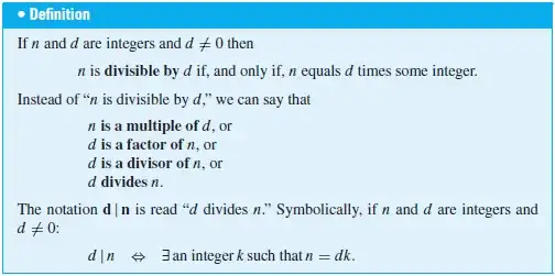

[Now I understand my question more after reading number theory chapter of a book]
$0=d\cdot 0 $
Thus, 0 is a multiple of every integer except 0.
