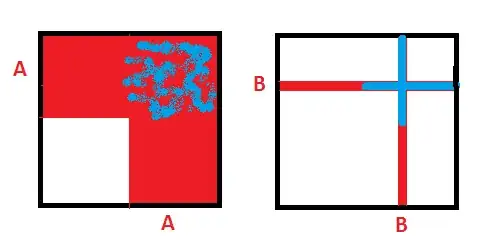

The overlap (possibility that both children are of the specific kind mentioned) is the issue, I think. Here’s a picture that helped me understand. Consider a random point $(x,y)$ in the unit square.
If you know that one of the two coordinates is bigger than $1/2$ (in set $A$), you have narrowed down the possibilities to the solid red region in the left picture. The chance that the other coordinate is also bigger than $1/2$ (you’re in $A\times A$) is about $1/3$ (blue-spotted part of the red region). It’s significantly less than the size of $A$ ($1/2$), because $A\times A$ is a significant part of $A\times I\cup I\times A$, the red region you know you’re in.
However, if you know that one coordinate is not only in $A$, but also in $B$ (say between $0.67$ and $0.71$), you are in the cross-shaped region on the right ($B\times I\cup I\times B$). The blue part of that region ($A\times B\cup B\times A$) is pretty close to $1/2$ of the cross, because the overlap is not so significant.
