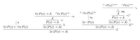

I'm a little bit puzzled by your proof in the case 2, i.e. under the assumption $\lnot \forall x \, P(x)$. As your proof should be valid classically but not intuitionistically (since it uses the law of excluded middle), you cannot infer from $\exists x \, \lnot P(x)$ that $P(c)$ (your step 3), the best you can classically do is apply the Herbrand's theorem. Indeed, in natural deduction (see Prawitz's Natural Deduction) the elimination rule for $\exists$ is NOT of the form
\begin{align*} \frac{\exists x A}{A[c/x]} \end{align*}
So, I think that you have to reformulate the case 2 as follows. Assume $\lnot \forall x \, P(x)$; this means that $\exists x \, \lnot P(x)$. Let us suppose that $x$ is such that $\lnot P(x)$: then $P(x) \to A$ since any statement can be proven from a contradiction (ex falso quodlibet), in particular $A$. Hence, for any $x$ such that $\lnot P(x)$ we have proved that $\exists x \, (P(x) \to A)$. Therefore, under the assumption $\lnot \forall x \, P(x)$, we have proved that $\exists x \, (P(x) \to A)$.
I formalized your whole proof of $\forall x \, P(x) \to A \vdash \exists x \, (P(x) \to A)$ (following my argument for the case 2) in Prawitz's natural deduction (I suppose you are referring to natural deduction when you say "how to handle introducing and eliminating quantifiers"):
where $\pi$ is a derivation in classical natural deduction (but it is not intuitionsitically valid) of the instance $\forall x \, P(x) \lor \lnot \forall x \, P(x)$ of the law of excluded middle, and $\pi_0$ is a derivation in classical natural deduction (but it is not intuitionsitically valid) of $\exists x \, \lnot P(x)$ under the assumption $\lnot \forall x \, P(x)$. I can detail $\pi$ and $\pi_0$ but I think it is out of scope of this discussion.
  • Thanks. I don't see how your second case works. If you are going to assume $P(y)$ then when you prove your contradiction than at best you've proved that $P(y) \to \bot$. I don't see how you can conclude $\bot$. – Michael Welch Dec 16 '15 at 13:29
