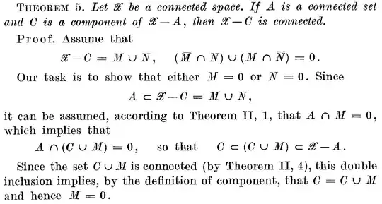

I have an exercise found on a list but I didn't know how to proceed. Please, any tips?
Let $X$ be a connected subset of a connected metric space $M$. Show that for each connected component $C$ of $M\setminus X$ that $M\setminus C$ is connected.

Here is the theorem found on Kuratowski's book. Thanks for the reference, it is a very excellent book. print screen

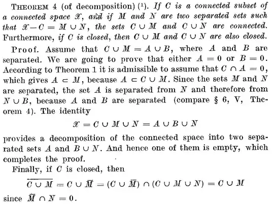

The Theorem II.4 cited above:
Theorem II.4

  • what is the Theorem II, 4 referred to in the proof? I don't see why $C \cup M$ must be connected... in fact, it seems that $M$ must lie in components of $\mathcal{X} - A$ other than $C$. – Herng Yi Aug 27 '12 at 13:55
  • I edited above. – Sigur Aug 27 '12 at 23:55
