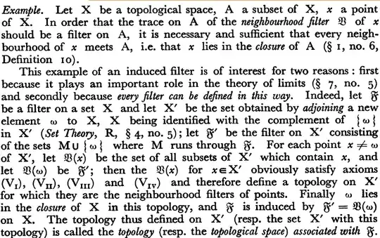

Let $X$ be a topological space. Then a filternet (this is a term I made up) in $X$ consists of a set $I$, a filter $F$ on $I$, and a map $I\to X$ (written $i\mapsto x_i$). We say $(x_i)$ converges to a point $x\in X$ if for each neighborhood $U$ of $x$, $\{i\in I:x_i\in U\}\in F$.
Isn't a filternet merely a continuous map $I\sqcup_{F} \{\infty\}\to X$ where the topology on $I\sqcup_{F} \{\infty\}$ is such that $F$ is the filter of neighbourhoods of $\infty$, and $\infty$ is a closed point, and the induced topology on $I$ is discrete? Explicitly, a subset $U$ of $I\sqcup_{F} \{\infty\}$ is open iff it either $\infty\not\in U$ or $U\setminus\{\infty\}\in F$. By the very definition of continuity, the map $(x_i),x_\infty=x: I\sqcup_{F} \{\infty\}\to X$ is continuous iff for each neighbourhood $U$ of $x$, $\{i\in I:x_i\in U\}\in F$, i.e. $(x_i)$ converges to a point $x\in X$.
This space is defined in Bourbaki, General Topology, \S6.5, Def.5, Example, see the picture above. In \S7.5 they do discuss convergence in terms of the trace filters but do not mention explicitly this construction. And I do not think I havev seen a reference explicitly discussing convergence in terms of these maps.
  • I will add a link to this post of mine - although it is about nets rather than filternets: Reference for convergent nets as continuous functions from $D\cup{\infty}$ – Martin Sleziak Dec 31 '21 at 15:11
  • thanks, I added the text by Bourbaki, and a remark that they do discuss convergence in terms of the trace filters but do not mention there this particular construction. – user1010515 Jan 01 '22 at 11:07
