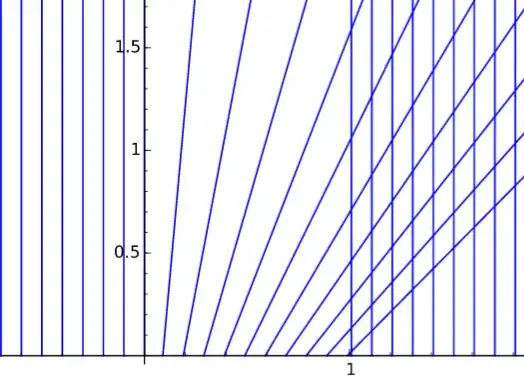

The characteristics of the Burgers equation are straight lines: namely, the characteristic emanating from $(x_0,0)$ has equation $x=x_0+\rho(x_0,0)t$. In your case, this translates into three groups of characteristics:
  1. $x=x_0$, $x_0\le 0$
  2. $x=x_0(1+t)$, $0<x_0\le 1$
  3. $x=x_0$, $x_0>1$
However, the latter two groups intersect, indicating that a shock wave forms at $ x=1$ at the moment $t=0 $. On the diagram, vertical axis is $t$:
intersect
Solving for $x_0$ from the second equation yields $x_0=x/(1+t)$, hence $\rho(x,t)=\rho(x_0,0)=x/(1+t)$. The solution is:

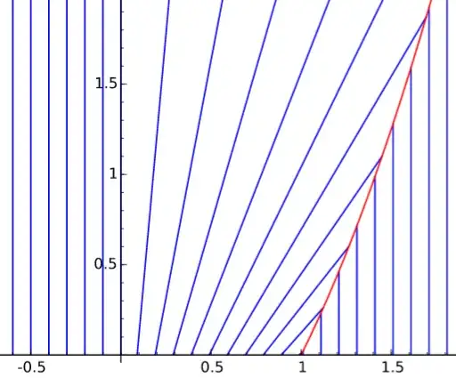

The shock wave propagates at the average of the velocities to the left and right. Thus, its position $s(t)$ satisfies $$\frac{ds}{dt} = \frac{s}{2(1+t)},\quad s(0)=1$$ Solving this ODE yields $s = \sqrt{1+t}$.
Draw this trajectory (it's a parabola) and erase extraneous bits of characteristics: they terminate when reaching the shock wave.
shock
