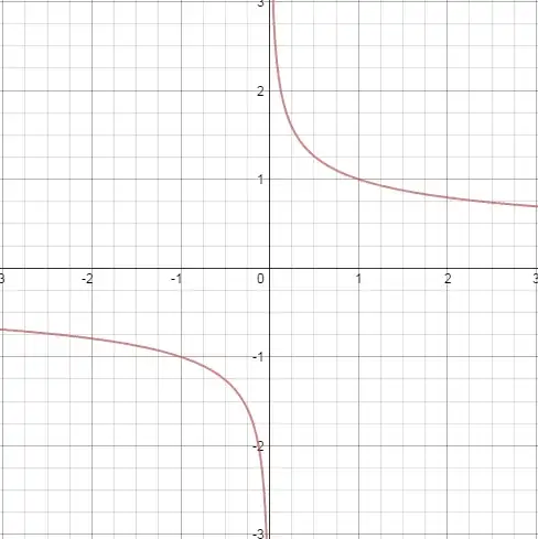

Question: Let $f:\mathbb{R}\setminus \{0\}\rightarrow \mathbb{R}$, with $f(x)=x^{-\frac{1}{3}}$ and let $A$ denote the area of region bounded by $f(x)$ and the $X$-axis, when $x$ varies from $-1$ to $1$. Which of the following statements is/are TRUE?
$f$ is continuous in $[-1, 1]$
$f$ is not bounded in $[-1, 1]$
$A$ is nonzero and finite
Answer:
The statement 1. is FALSE. Reasoning: In order to be continuous in $[-1,1]$ the function $f$ has to be continuous at each point of $[-1,1]$. Since $f$ is not defined at $x=0$, it is neither continuous nor discontinuous at $0$. But $f$ is continuous in $[-1,1]\setminus{\{0\}}$.
Comment to your reasoning since left limit is not equivalent to right limit:
You are addressing the point $0$, so you should specify it because at all other points in $[-1,1]\setminus{\{0\}}$ the left limit of $f$ is equal to the right limit. The term equivalent has a specific mathematical meaning, so you should instead use the term equal.
The statement 2. is FALSE. Reasoning: In order to be bounded in $[-1,1]$ the function $f$ has to be defined in $[-1,1]$ which is not true for $x=0$. Furthermore $f$ is not bounded in $[-1,1]\setminus{\{0\}}$ since e.g. the limit $lim_{x\rightarrow 0^-}=-\infty$.
Comment to your reasoning since $f(x)$ rises to $infinite$ at $x=0$:
Since the function $f$ is not defined at $x=0$ it is better to write since $f(x)$ rises to $infinite$ when $x$ tends to zero. This formulation considers only values $x$ within the domain of $f$.
The statement 3. is FALSE. Reasoning: It is assumed that $x$ varies within the domain $[-1,1]\setminus{\{0\}}$ of $f$ and we further assume the area $A$ is a signed area. Since integration of the positive part of $A$ results in
\begin{align*}
\lim_{a\rightarrow 0^+}\int_{a}^{1}x^{-\frac{1}{3}}\,dx&=\frac{3}{2}\lim_{a\rightarrow 0^+}\left. x^{\frac{2}{3}}\right|_a^1=\frac{3}{2}
\end{align*}
which is finite, we obtain due to symmetry $A=0$.
Comment to your reasoning since we can calculate it by doing integrating the function.
The wording is not precise enough, since we are able to calculate an integral and the result might be $\pm\infty$. We have to state that we get a final value by integration.
Usually when integration is involved, we consider areas as signed. That's why I calculated $A=0$. But maybe, according to your conventions with respect to such questions, you have to consider an unsigned area. In this case we obtain $A=3$ and your answer TRUE is correct.
