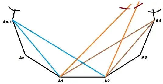

Consider a side $\mathrm{A_1A_2}$ of regular n-polygon. To get a triangle with only one side $A_1A_2$ common (As shown in figure-1 below)
Figure-1 (figure-1)
Join the vertices $A_1$ & $A_2$ to any of $(n-4)$ vertices i.e. $A_4, \ A_5,\ A_6, \ \ldots \ A_{n-1}$ to get triangles with only one side common. Thus there are $(n-4)$ different triangles with only one side $A_1A_2$ common. Similarly, there are $(n-4)$ different triangles with only one side $A_2A_3$ common & so on. Thus there are $(n-4)$ different triangles with each of $n$ sides common. Therefore, number of triangles $N_1$ having only one side common with that of the polygon $$N_1=\text{(No. of triangles corresponding to one side)}\text{(No. of sides)}=\color{blue}{(n-4)n}$$
