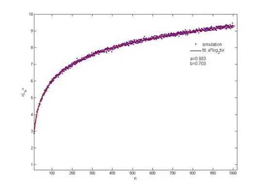

Some intuition about what you can expect can be found here: Longest Run of Heads.
Let the random variable $L_n$ be the largest contiguous heads sequence in $n$ coin tosses (suppose the coin is biased with heads probability $p$).
In the paper you can find the following intuitive approximation to the expectation of $L_n$: denote by $N_k$ the expected number of heads sequences having length$\ge k$. Since each tails outcome is a possible beginning of a heads sequence(ignoring edges), the expected number of heads sequences with length$\ge 1$ is $N_1\approx n(1-p)p$. Similarly, for length$\ge 2$ sequences the expectation is $N_2\approx n(1-p)p^2$ and generally $N_k\approx n(1-p)p^k$. Now you can approximate the expectation of $L_n$ by the solution to $N_k=1$ and this yields: $L_n$
$\langle L_n\rangle\approx -\log_pn(1-p)=\log_\frac{1}{p}n(1-p)$.
Although this appears extremely loose, it gives you an idea about the asymptotic behaviour $\langle L_n\rangle$ (logarithmic growth).
More accurately, you have $\frac{L_n}{\log_\frac{1}{p}n} \rightarrow 1$ in probability, i.e. $\forall \epsilon>0 \lim\limits_{n\to\infty}\mathbb{P} \left(\left|\frac{L_n}{\log_{1/p}n}-1\right|>\epsilon \right)=0$.
You may want to look at the following plot I got a while back. For $1\le n\le 1000$ $\langle L_n\rangle$ is calculated using $1000$ trails of $n$ unbiased coin tosses:

  • Nice graphic. It actually helped me realize that as you flip a coin more and more, the max number of head coin flips in a row you witness will increase gradually over time. It's also interesting to see that it will also start to flat out as the amount of flips increases. I'm assuming the plot will eventually start to look like a flat horizontal line with very little movement after a while. I'm guessing we could probably also calculate how many times on avg. you would have to flip a coin to get a certain number of heads in a row. mind blown – Juan Velez Aug 25 '15 at 20:02
    "I'm assuming the plot will eventually start to look like a flat horizontal line with very little movement after a while" - well, it grows logarithmically, so clearly the length of the longest sequence tends to infinity (although slower than you might have expected). As to your last comment, suppose you managed to calculate the probability $p_k$ of having a largest sequence of size $k$ (in $n$ tosses), then the number of $n$ tosses trials you need in order to witness a $k$ longest sequence is geometrically distributed and it's expectation is $\frac{1}{p_k}$. – Ariel Aug 25 '15 at 20:24
  • @Ariel: yes, and yet in another sense it does tend to a flat line because the slope approaches zero! Such is the way of limits. – wchargin Aug 26 '15 at 01:12

Note: The expression (4) is a good approximation. We obtain for $n=1000$ the expectation value \begin{align*} \mathbb{E}_{1000}(L)=\lg(1000)+\frac{\gamma}{\log(2)}-\frac{3}{2}\doteq 9.29853\tag{6} \end{align*} and the first Fourier coefficient has amplitude: \begin{align*}\frac{\left|\Gamma\left(\frac{2i\pi}{\log 2}\right)\right|}{\log 2}\doteq 7.86\cdot 10^{-7}\end{align*} and since the fluctuations of the Fourier expansion is of order $10^{-6}$, the value stated at (6) is rather accurate.
Note, that the value $9.29853$ at $n=1000$ nicely matches with the $graph$ presented in the answer from @Ariel and the first order approximation $\lg(n)$ is the one provided in the answer by @leonbloy.
