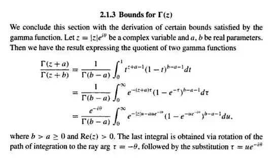

Thanks to joriki's link to Google Books, here is the passage in question.
R. B. Paris and D. Kaminski, Asymptotics and Mellin-Barnes Integrals, pp. 33-34.
For real $x>0$, the strict log-convexity of $\Gamma$ (see the end of this answer) implies that for $a\ge0$, $b\ge1$ and $b\ge a$, $$ \frac{\log\Gamma(x+1)-\log\Gamma(x)}{1}\le\frac{\log\Gamma(x+b)-\log\Gamma(x+a)}{b-a}\tag{1} $$ Which translates to $$ \frac{\Gamma(x+a)}{\Gamma(x+b)}\le\frac{1}{x^{b-a}}\tag{2} $$ Simpler, but not as general.
