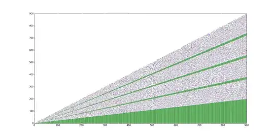

B) Then each element $a_{ni}$ is replaced by $f(a_{ni})=\sqrt{a_{ni}}-\lfloor \sqrt{a_{ni}} \rfloor$ truncating up to 7 decimals.
C) Finally, $\forall f(a_{ni})$ now it is possible to find the first occurrence of for instance $k=0$ in $f(a_{ni})$. It is found starting from the upper decimal value. The position where it is found is the "escape position", and each position will have its own color.
This is the plotting of colors of each escape position for the algorithm when looking for the first occurrences of $k=0$ in $f(a_{ni})$:

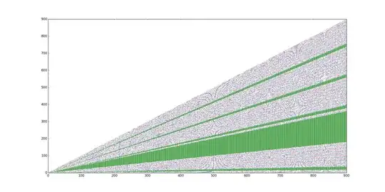

Same exercise for the first occurrences of $k=1$:
They are very similar, but they are not the same. It seems that there are star-like patterns acting like local "attractors" (please excuse me if I abuse of the terminology).

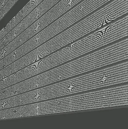

I have plotted the images with a gray scale gradient, so now it is possible to see more details of the above rotating picture:

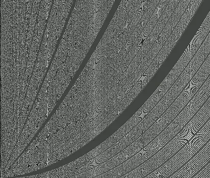

The following animation is the search of the position of the first decimal value $k=0$ in the fractional digits obtained by applying the functions $f(n)=n^{t}-\lfloor n^{t} \rfloor$ where $t \in [0.49995..0.50006]$ each frame is increasing by $0.00001$. The pattern "bends" in $XY$ and the background star-like patterns are relocated depending on the slight changes of $t$.

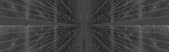

Finally, as $+XY$ is symmetric in $-XY$ this is how it looks like the complete picture, without the restriction regarding the values being less than the next square, so it fills the $XY$ plane completely:

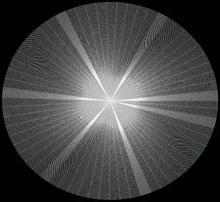

I have been able to isolate the same star-like pattern in polar coordinates $(r,\theta)$ using the same algorithm for a different function. In this case:
$r=\lfloor \frac{n}{2\pi} \rfloor$, $n \in \Bbb N$
The value of the angle in percentage will be the fractional part:
$\theta_\%(n) = \frac{n}{2\pi}-\lfloor \frac{n}{2\pi} \rfloor$
thus:
$\theta= \theta_\%(n) \cdot 2\pi = (\frac{n}{2\pi}-\lfloor \frac{n}{2\pi} \rfloor) \cdot 2\pi = n - (\lfloor \frac{n}{2\pi} \rfloor \cdot 2\pi)$
Each frame of the cyclical animation represents $\forall n \in [0,10^7]$ the search of $k=0$,$k=1$,...,$k=9$ in $\theta_\%(n)$ (the value of the fractional digits of the angle truncated up to $7$ decimals):

As requested, color codes and explanation about the plotting (initial multi-color graphs above):
  1. Color code:
Associated to positions of $k \in \{0,1,2,3,4,5,6,7,8,9\}$ when found at the decimal position $p$ (starting from the decimal point).
$p=0=$"green (big frame)", $p=1=$"green" (small frames), $p=2=$"cyan", $p=3=$"blue", $p=4=$"magenta", $p=5=$"red", $p=6=$"yellow", $p=7=$"white".
e.g. 0.354697812
$k=1$ is at position $p=7$, white
$k=3$ is at position $p=0$, green (big frame)
$k=4$ is at position $p=2$, cyan
$k=5$ is at position $p=1$, green (small frames)
$k=6$ is at position $p=3$, blue
$k=7$ is at position $p=5$, red
$k=8$ is at position $p=6$, yellow
$k=9$ is at position $p=4$, magenta
if $k$ is not found in the first seven positions, the associated position is the deepest one, $p=7$.
$k=2$ is at position $p=8$, $8 \gt 7$, so it is white too.
  1. Plotting of the initial examples above (multi-color graphs)
The tickers (units) of the $x$ axis are $n^2, n \in \Bbb N$, so $x=0$ represents $0^2$, $x=1$ represents $1^2$, $x=2$ represents $2^2$ ... $x=i$ represents $i^2$.
The tickers of the $y$ axis are $m \in \Bbb N$: 0,1,2,3...
So each plotted point $(x,y)$ represents the color code of the pair $(n^2,m)$ converted into $\sqrt{(n^2+m)}-\lfloor \sqrt{(n^2+m)} \rfloor$, in other words, the fractional part of $\sqrt{(n^2+m)}$, truncated to 7 digits.
Summarizing: each graph is the plotting of the search of an unique $k$ in all the pairs $(x,y)=(n^2,m)$ of the XY plane (the initial graphs above were restricted to $n^2+m \lt (n+1)^2$, that is the reason why they are triangular graphs and do not fill the whole $XY$ plane). For instance, the first graph added in the question is the search $\forall (x,y)=(n^2,m)$ of the first occurrence of the digit $k=0$ in the first 7 truncated digits of the fractional part of $\sqrt{(n^2+m)}$.
