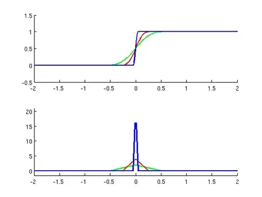

I'd like to add an answer that will try to justify the statement with an example. Consider the function sequence $$ f_n = \left\{\begin{align} 0 \ \ &\text{ if } |x|>1/n \\ n^2x^2/2 + nx + 1/2 &\text{ if } -1/n\leq x \leq 0\\ -n^2x^2/2 + nx + 1/2 &\text{ if } 0<x\leq 1/n \end{align}\right.. $$
These functions are differentiable everywhere, and they approximate the unit step function better and better as $n$ gets larger. If we look at the derivatives of these functions, we'll see that they are a sequence of tent functions that are getting narrower and taller, as Griffith uses to introduce the delta function.
alt text
Actually, with an appropriate mode of convergence, when a sequence of differentiable functions converge to the unit step, it can be shown that, their derivatives converge to the delta function. That's why, one may take the derivative of the unit step function to be defined as the limit of the derivatives, which is the delta function.
