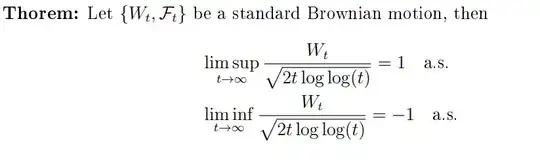

Now on one hand by the law of the iterated logarithm . More preciselly this paricular caset of the theorem on the Brownian motion:
enter image description here We can writte: $lim_{s\rightarrow \infty } |\frac{X_s}{\sqrt{2slog(log(s))}}|=1 \ a.s.$
On the other hand we have: $lim_{s\rightarrow \infty } |\frac{\sqrt{2slog(log(s))}}{\sqrt{s}}|=0 \ a.s.$
So easily we can conclude: $lim_{s\rightarrow \infty } |\frac{1}{s}X_{s}|=1\cdot 0=0 \ a.s.$
