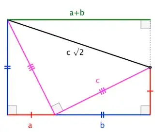

74
Proof without words:
(This space intentionally left blank.)
