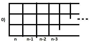

In the case of a $2\times n$ grid, the resulting Fibonacci recurrence is pretty much clear, and you can read up on the solutions on Wikipedia. However, I believe the previous answers have not treated the $3\times n$ case with enough care, so I'd like to fill that gap. Please, let me know of mistakes if there are any.
So we start with a grid such as
To make a first step in the iteration, we ask the question: how can we put a number of dominos on this grid in all different ways such that the first column labeled by $n$ is covered completely?
The possible variations clearly are:
This reveals that apart from the initial $3\times n$ type grid, the number of different tilings for which we can denote as $f_n$, we also need to consider a second grid of $3\times n$ type with one corner missing, the number of tilings for which we call $g_n$. (By symmetry, it does not matter whether an upper or lower corner is missing, the number of tilings will be the same.)

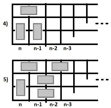

Since we have introduced the quantity $g_n$, it seems we need a recurrence relation for it as well. For that end, we consider all possible ways to add dominos to the grid 1) above, such that all squares of column $n-1$ are covered:
Note that in grid 5) we also have added an additional domino occupying columns $n-2$ and $n-3$ at the top, since this is the only possible way to cover the remaining square in column $n-2$ anyway.
This suggests the following recurrence for $g_n$:
$$g_{n-1}=f_{n-2}+g_{n-3}$$
