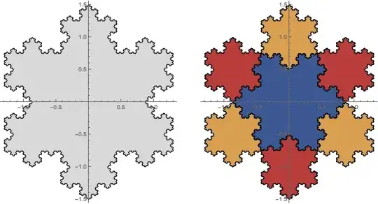

For concreteness sake, let's suppose we are computing the moment of inertia of the Koch Snowflake $K$ of uniform density and mass 1 shown on the left below. This snowflake is centered at the origin and has diameter 3 - that is, the maximum distance between two points is three. From here, it would be easy to compute the moment of another Koch flake of different size and uniform density, as long as it's centered at the origin.
The moment of inertia of this flake $K$, as I understand it, is simply $$\iint\limits_{K} (x^2+y^2) \, dA$$ divided by the area of the snowflake. There are any number of tools that can compute this numerically. Using Mathematica, I came up with 0.813719. (I could provide code, if desired.)
This value can also be computed exactly using the theory of self-similar integration as described in Bob Strichartz paper Evaluating Integrals Using Self-similarity. Applying this, I computed an exact value of $9/11$ or $0.\overline{81}$. The remainder of this answer will describe that process, though it does require a fairly sophisticated knowledge of self-similarity and measure theory.
We will use the fact that the Koch Snowflake is self-similar - composed of 7 copies of itself as shown in the figure above on the right. The scaling factor for the middle piece is $1/\sqrt{3}$ and it's $1/3$ for the others. Let us suppose that the functions in the IFS mapping $K$ onto the individual pieces are $T_0,T_1,\ldots,T_6$, with $T_0$ mapping onto the central piece. The exact functions in the IFS are

An answer based off Mark McClure's but involving less theory and invoking the parallel axis theorem.
If we assume that the moment of inertia is always proportional to the mass, and proportional to the square of a characteristic length scale (in this case the length of the diameter as in Mark's answer), then $$ I = \gamma Ml^2, $$ where $\gamma$ is a constant. Using the principle of superposition, $$ I = I_{\text{centre}} + 6I_{\text{edge}}, $$ where the centre snowflake is in blue and the edge snowflake's are red/brown. Now $$\displaystyle I_{\text{centre}} = \gamma \frac{M}{3}\left(\frac{l}{\sqrt{3}}\right)^2 = \frac{\gamma}{9}Ml^2 = \frac{I}{9}.$$ Using the parallel axis theorem, $\displaystyle I_{\text{edge}} = I_{\text{COM}} + Md^2$, where $I_{\text{COM}}$ is the moment of inertia through the centre of mass, and $$\displaystyle I_{\text{COM}} = \gamma \frac{M}{9}\left(\frac{l}{3}\right)^2 = \frac{\gamma}{81}Ml^2 = \frac{I}{81},$$ and $d = l/3$, so $$\displaystyle I_{\text{edge}} = \frac{I}{81}+ \frac{Ml^2}{9},$$
So \begin{align*} I &= \frac{I}{9} + 6\left(\frac{I}{81}+ \frac{Ml^2}{9}\right), \\ I & = \frac{15I}{81} + \frac{2Ml^2}{3}, \\ \frac{22I}{27} & = \frac{2Ml^2}{3}, \\ I & = \frac{Ml^2}{11} \end{align*}
If we let $l=3$ we recover Mark's answer.
