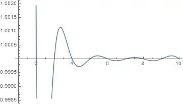

First identify a fixed point for an iterated function which can be a hyperoperator, $f^n(x)$. Now $f$ is a "horizontal or intra-hyperoperator function." And $g$ is a "vertical or inter-hyperoperator function".
Consider that $g(1\uparrow^x1)=(1\uparrow^{x+1}1)$ with $(1\uparrow^\infty1) = 1$ as a fixed point.
Mathematica 12 Code
$g[1]=1\uparrow1, g[2]=1\uparrow^21, g[3]=1\uparrow^31$
g[x_] := Interpolation[{2, 1, 1, 1, 1, 1, 1, 1, 1, 1, 1, 1, 1}, InterpolationOrder -> 12][x]
Plot[g[x], {x, 1, 10}, AxesOrigin -> {1, 1}]
Hyperoperators at 1.0
Note the period two nature of the function $g$ and the convergence to the fixed point $(1\uparrow^\infty1) = 1$. So $(1\uparrow^x1)$ extends the Ackermann function to real values.
Let $1\le a<2$. I conjecture that $a\rightarrow\infty\rightarrow\infty=a$
