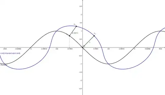

For example, this is $g(t)=cos(t)$, the imposer, imposed upon $f(t)=(t,a \cdot sin(t))$, the receiver, where $a$ is simply a real value which oscillates between $-1$ and $1$ with time. Basically, $a$ is the reason functions below are moving. a graph of cosine of t imposed upon an oscillating sine of t
The black function which resembles a standing wave, as I said before, is an oscillating sine function, and it is also the receiver. The blue function which, if you look closely, occasionally looks like a cosine function is the function resulting from imposing $g(t)$ onto $f(t)$. The green line segments are to illustrate the act of finding the point on the normal of $f(t)$ at $t$ with a distance of $g(t)$, like we covered in the above paragraphs.

If I understand your verbal description, the "receiver" is a "regular curve" $$ f(t) = \bigl(x(t), y(t)\bigr), $$ i.e., a (continuously-)differentiable curve with non-vanishing velocity. There is a unit tangent field $$ T(t) = \frac{f'(t)}{\|f'(t)\|} = \frac{\bigl(x'(t), y'(t)\bigr)}{\sqrt{x'(t)^{2} + y'(t)^{2}}} $$ and a unit normal field $$ N(t) = \frac{\bigl(-y'(t), x'(t)\bigr)}{\sqrt{x'(t)^{2} + y'(t)^{2}}}. $$ The result of "imposing" $g$ on $f$ is the pair of parametric curves $$ \gamma(t) = f(t) \pm g(t)N(t). $$
The closest common construction that comes to mind is the evolute, in which the imposer is the reciprocal of the curvature function of the receiver. (As Rahul notes in the comments, if $g$ is constant, then $\gamma$ is a "parallel curve" to $f$.)
You might search for references to "differential geometry of plane curves", "(unit) normal field", and the like.
