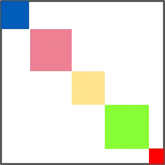

If you really need to use induction, here's what you need for the inductive step:
Assuming $(a_1^2+a_2^2+...+a_n^2 ) \le (a_1+a_2+...+a_n)^2$
then $$\begin{align} (a_1+a_2+...+a_n+a_{n+1})^2 &= ((a_1+a_2+...a_n)+(a_{n+1}))^2 \\ &= (a_1+a_2+...+a_n)^2+2(a_1+a_2+...+a_n)a_{n+1} + a_{n+1}^2 \\ &\ge (a_1+a_2+...+a_n)^2 + a_{n+1}^2 \tag{*}\\ &\ge (a_1^2+a_2^2+...+a_n^2 ) + a_{n+1}^2 \\ \end{align} $$as required. Note that $2(a_1+a_2+...+a_n)a_{n+1}\ge 0)$ for the (*) step.
You do require that all the $a_i$ are not negative.
Being visual myself, I prefer pictures....
