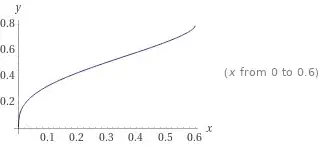

  1. With the second lemniscate constant L$_2$:
$$\E(x,2)=a\implies x=\frac12\sin^{-1}\left(\sqrt{\text I^{-1}_{\frac a{\text L_2}}\left(\frac12,\frac34\right)}\right),0\le a\le\text L_2$$
which is correct.

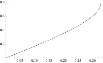

  1. Note Elliptic D$(x,m)$:
$$\E(x,-1)-\F(x,-1)=\operatorname D(x,-1)=a\implies x=\sin^{-1}\left(\sqrt[4]{\text I^{-1}_{\frac a{\text L_2}}\left(\frac34,\frac12\right)}\right),0\le a\le \text L_2$$
which is correct.

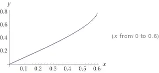

3.
$$\E(x,2)-\frac12\sin(2x)\cos^\frac32(2x)=a\implies x=\frac12\sin^{-1}\left(\sqrt{\I^{-1}_{\frac a{\text L_2}}\left(\frac32,\frac34\right)}\right),0\le a\le \text L_2$$
which also works
