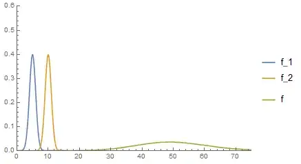

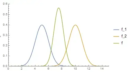

I am surprised @heropup's answer is accepted, because the original question is about the product of two Gaussian PDFs resulting in a new, scalar PDF (instead of a vector joint PDF like @heropup supposes). Although we have two Gaussian PDFs of different variables, i.e.
$$ f_1(x) \sim N(\mu_1,\sigma_1^2)\\ f_2(y) \sim N(\mu_2,\sigma_2^2), $$
they are multiplied by assuming some dummy variable $t$:
$$ f = f_1(t) f_2(t) \sim N(\hat{\mu},\hat{\sigma}^2) $$
which is a scalar PDF and not a joint PDF! An example is given below, with $\mu_1=5$, $\mu_2=10$ and $\sigma_1=\sigma_2=1$. The resulting $f$ is normalized so that it is a valid PDF. Due to the exponential nature of a Gaussian PDF, it peaks where both $f_1$ and $f_2$ are large.
The resulting $f$ should not be interpreted as the PDF of $Z=X\cdot Y$! This is obvious as the peak should not be near $7.5$ but rather near $\mu_1 \mu_2=50$ (see plot below).
Note that $f$ in this plot is generally not Gaussian.
